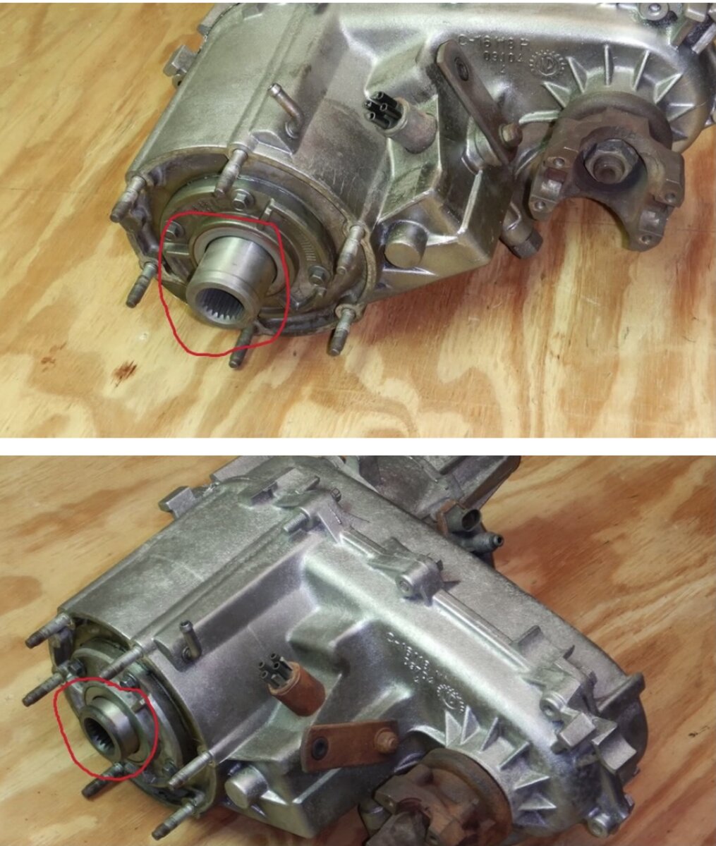

On a somewhat related note, it would be cool if you could take some pics of the transfer case when you remove it. Novak claims that an automatic jeep uses a long stickout length on the transfer case input gear shaft. Manuals supposedly always use a short stickout. My manual always used short, but Novak is known for being wrong. I'm curious what your auto had from the factory. The pic circles them and you can obviously see the differences. Curious to see which one you have. If you have the short one, you will be good to go for the AX15. If you have the long one, you'll probably have to swap it to a short gear or else I believe it bottoms out on the bearings inside the AX15 and can damage the transmission. So try to remember to take some pics if you could.

hmm, Cherokees are a bit different since they had different automatics from the factory so their transfer cases were setup a bit different. I do know that all of them can be fixed with no sawing by swapping the gear in the transfer case which you can easily do during the SYE process. It only adds a few extra steps. Hopefully you won’t have to mess with it at all, apparently lots of YJ autos came with the same short shaft as the manuals (contrary to what Novak says) so it very well may work as it is. Just have to see later.
