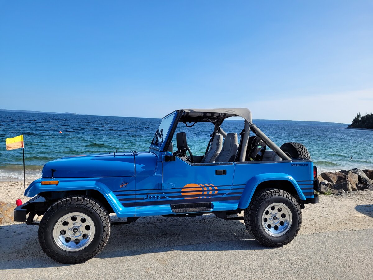

My current profile picture is with the 235s and yup, the offset of the TJ Alcoas is perfect - fully under the flairs. Mine are the 15 inch version from a Rocky Mountain Edition. There was also a 16 inch version from the Tomb Raider models.

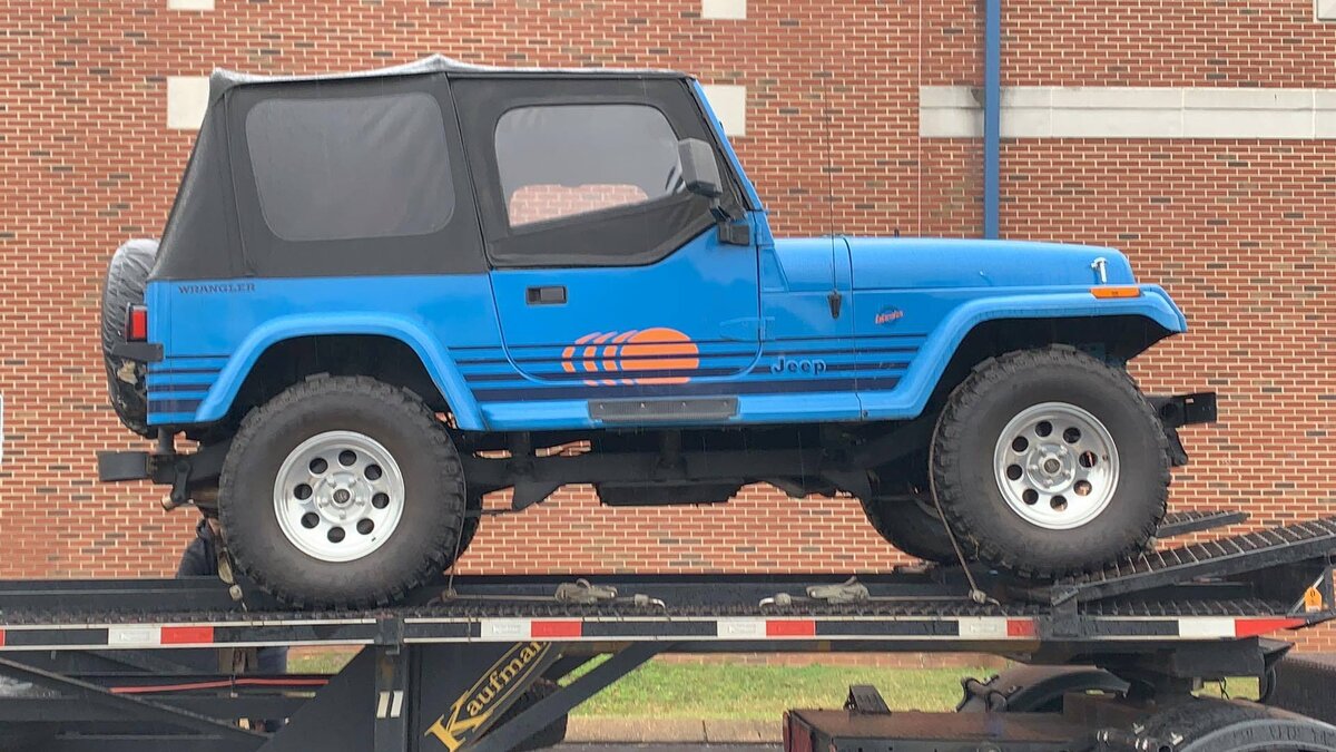

For reference - 1st picture is when I bought it and it was being shipped to me - had the 32s/body lift
2nd picture - present - stock height with the 235s.
