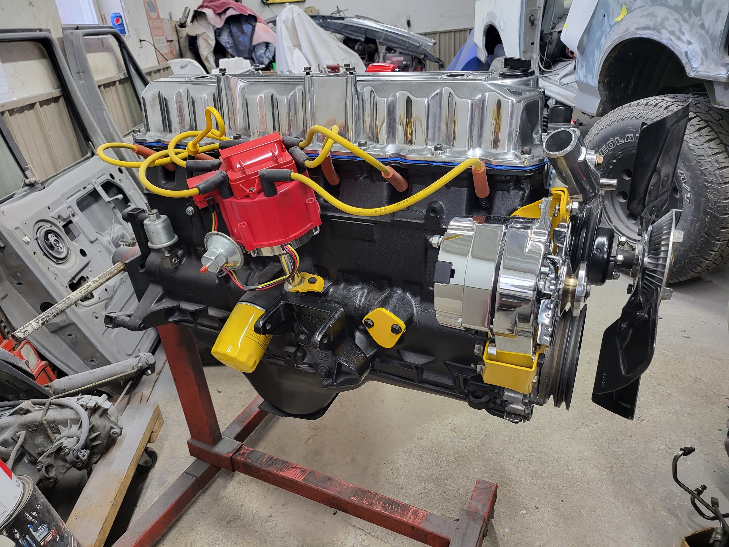

I surely appreciate all the good input. Ordered the LuK from Summit this morning... along with a chrome p/s reservoir.
Maybe I've gone too far! 🤭
so long as she gets me home...
Anyone out there ever deal with Newcomer Racing?
He has some roller rockers, spacer for the valve cover, and other goodies I've on the wish list.
