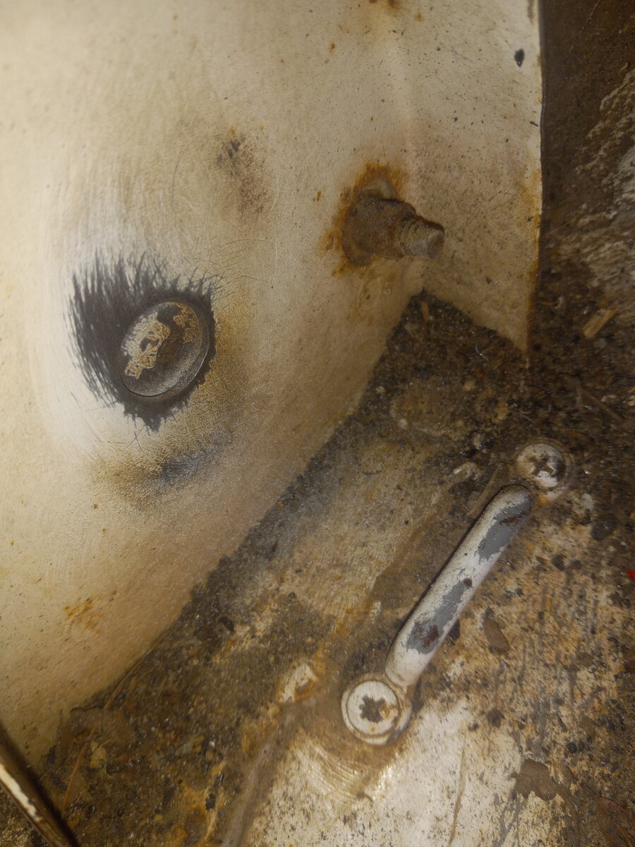

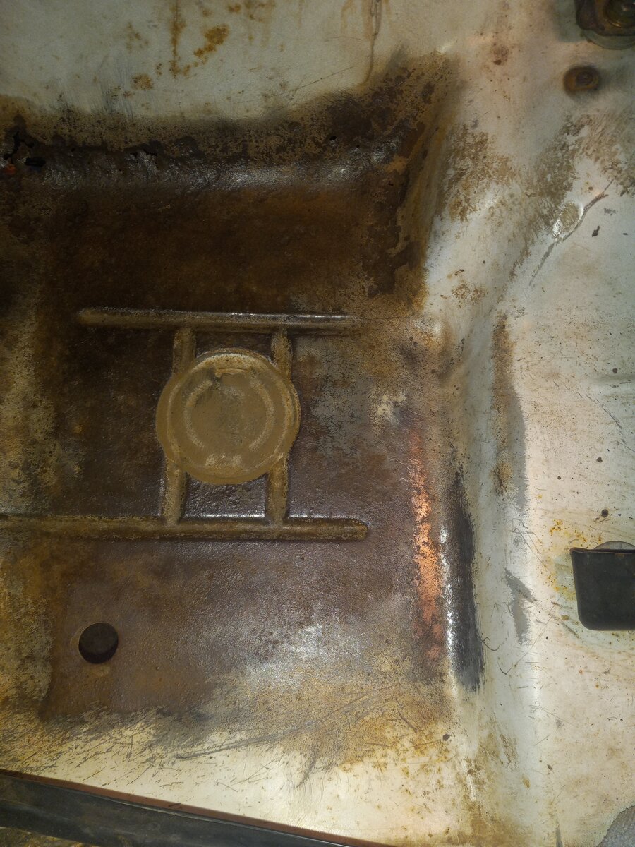

Oh wow, your's were pretty bad. Luckily mine are no where near that extent. I have it on the corners of my driver's side pan on the tunnel cover side. Everything else in the interior is pretty much still solid.

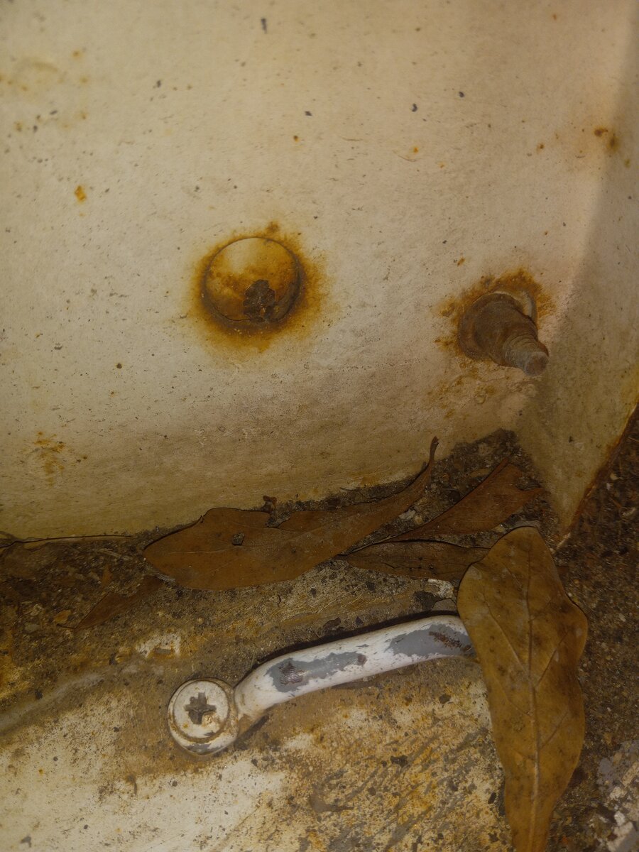

For the side chamber on the and image, was it rusting from the inside? It looks like it was rusting in between. Mine has rust in the hole and along the cracks of the chamber. I couldn't tell you if it was rusting underneath, but I guess I would see it eat through the outside of the tub.

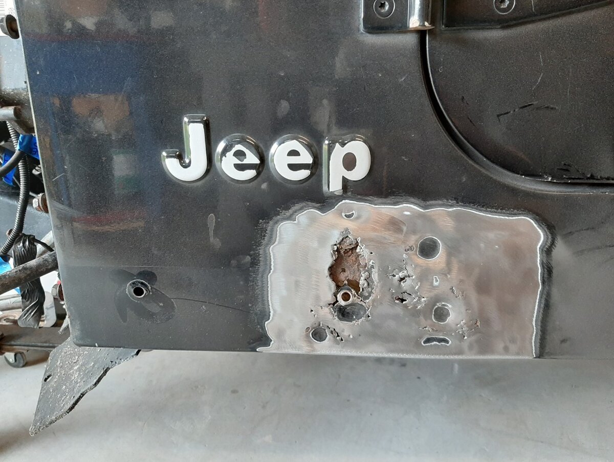

Yeah it's strange because the right passenger side still looks new, even the paint, but the left driver's side was very worn and rusty. I think water did get between the door pillar and outer skin.
The outer skin was paper thin, maybe just paint and this is what it looked like after sanding. To buy that corner patch section was over $200 so I cut out the bad stuff and replaced it. Then added nutcerts for the rubber trim.

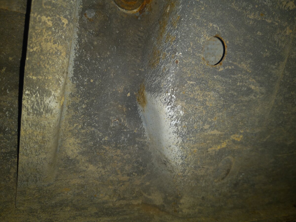

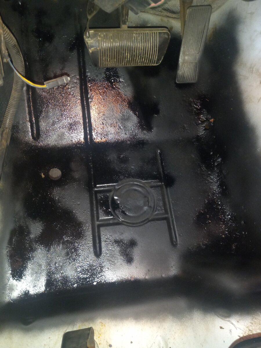

Did the best I could sanding with a few wire wheels. I Sprayed Rustoleom Rust Reformer to protect until I can get a chance to cut and weld.
I also noticed that there seems to be some bed liner already sprayed underneated.
I should have did this day one. I just didn't think it would be this bad in a year. Might have been this bad to begin with.

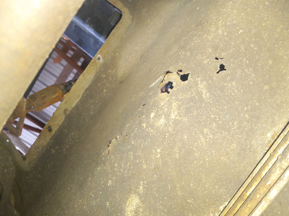

Started sanding what I thought was surface rust on my driver side panel, and I now have a few quarter size holes and some cracking going on. I am going to have to patch weld. Luckily that is the worst of it. Most of my tub interior still has the original paint job and clear coat. As much as I do not like the look of liner, I think it may be best to spray it on my tub to protect it from further rusting. I plan on driving it and getting it wet. May even drive it in the rain with no top.
