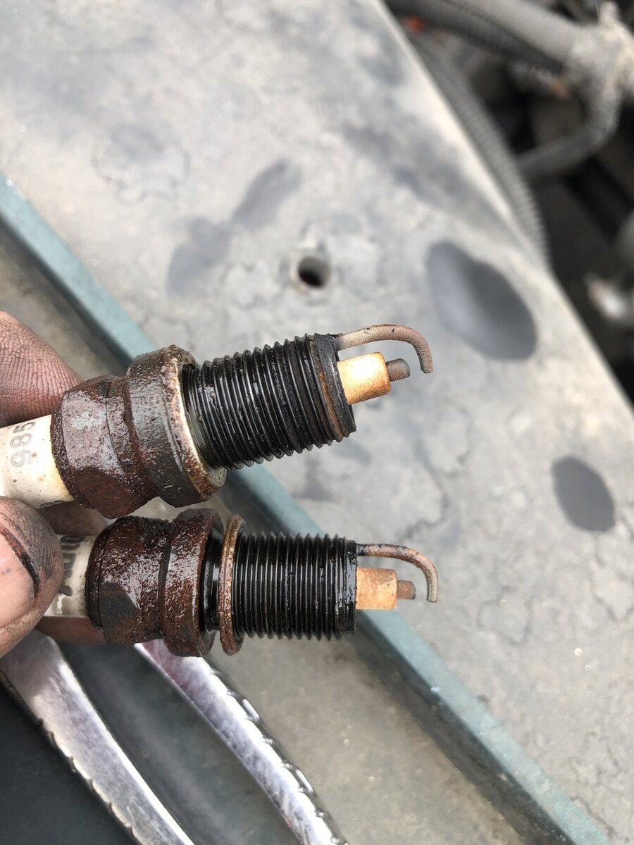

@Flyer58 OK, I got no spark for the first two spark plugs. So, the testing says that the ignition system has a faulty component. I assume since the first two spark plugs weren’t getting any spark then probably none of them are. The spark plug wires look good. I"m looking for the stupid camshaft position sensor. Not sure how to test it. I read that you can turn the engine over manually and check it with a multimeter. Heading back to the auto parts store to borrow a fuel pressure regulator to test that. What else should I look at next? Distributor?

2 of the plugs

Well the plugs look like they need replacing. Not sure about the CPS, but you should be able to look in the FSM and there should be a testing procedure, just like there is with the TJs.
