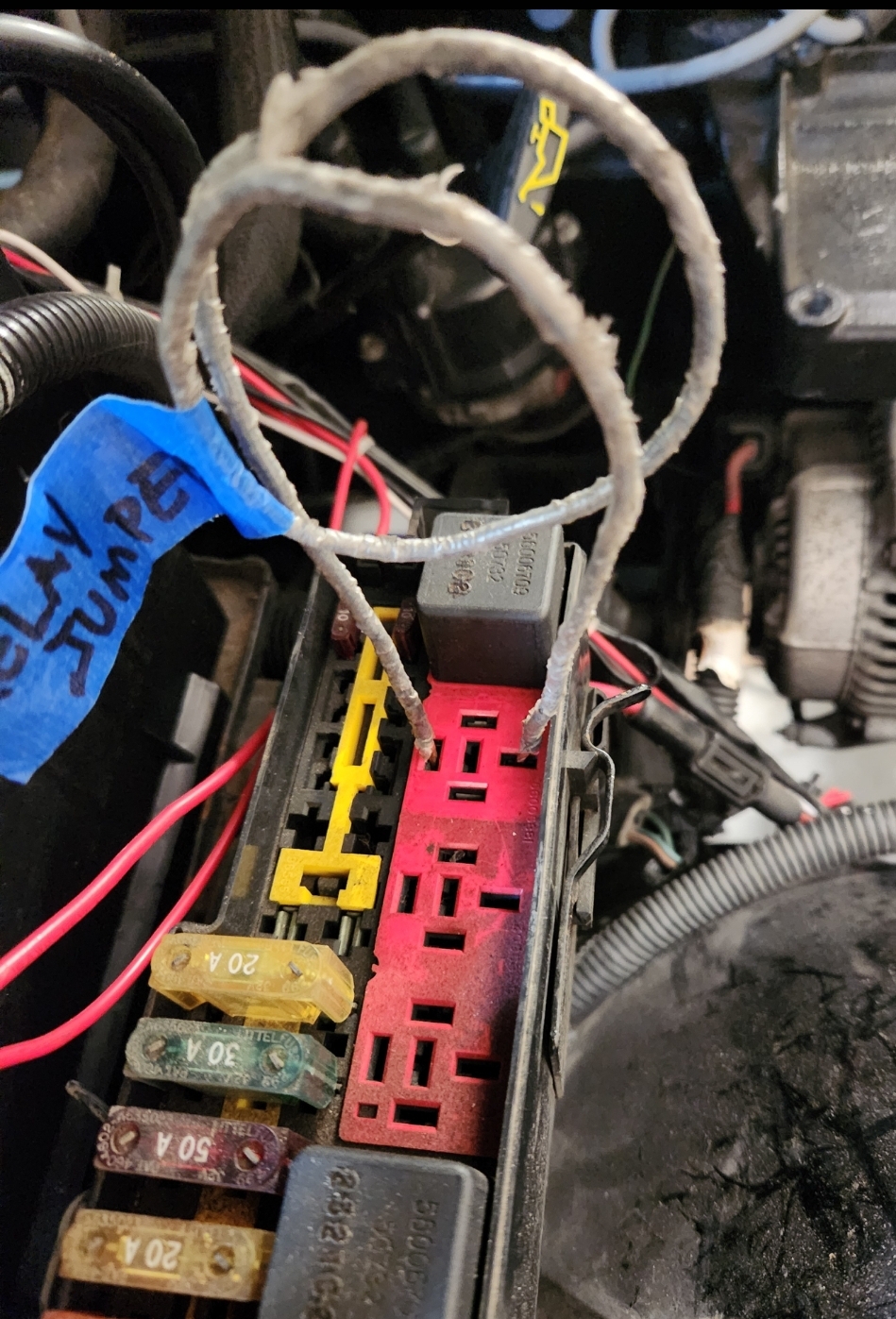

Do you hear the pump run for a few seconds when you turn the key on? You can put a jumper wire across the terminal connection where the relay plugs in to test the pump and wiring. If the pump is running and still no pressure then maybe the fuel filter is plugged.
