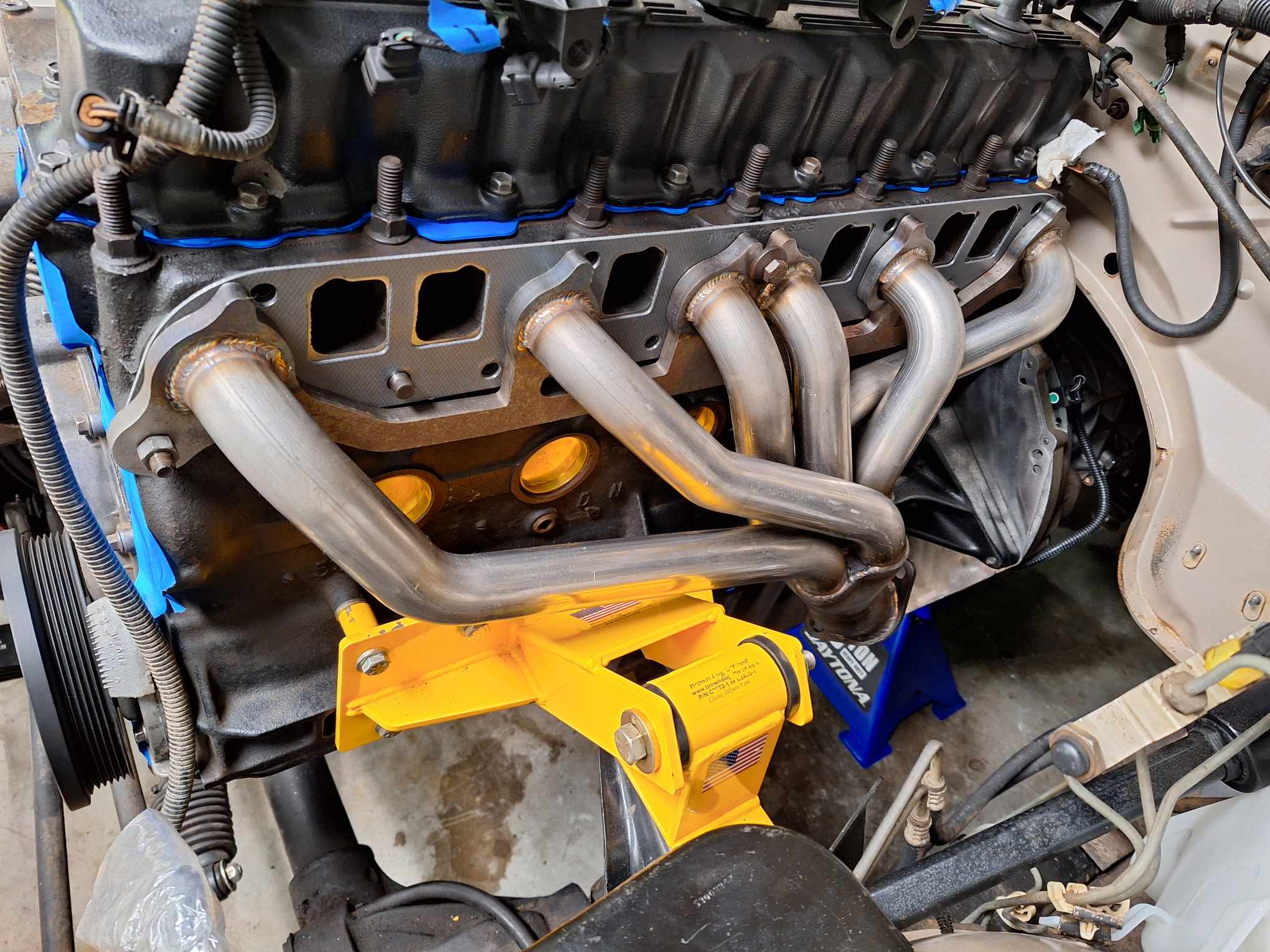

I am looking at this option myself. I purchased a Banks revolver about 3 years ago for my old 91 YJ but it wound up staying in the box. I just installed it on my 95 Sahara that I have been rebuilding so I cannot comment on longevity but I do like the idea of a flex pipe, like all the FWD cars I have had. I also have a JBA mid pipe for the TJ that brings the exhaust in front of the oil pan. On test fitment, I need to move the mount back a couple of inches as it's pressed right on the Banks header. The angles are not great where it meets the header but stock isn't either. Hoping the lead adapter will seal it up. I hadn't thought about a flex pipe but that is a great idea. I will check out that video as I am currently trying to figure out the rest of the exhaust and what muffler to go with.
