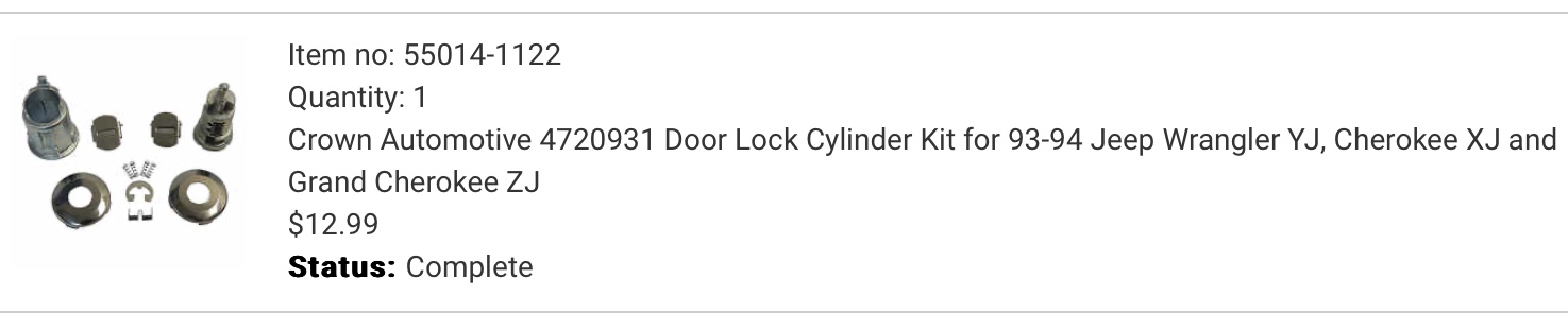

Hey there. Don’t know if you’ve solved this yet or not, but i recently swapped out my driver door lock cylinder on my ‘94 YJ and here’s my two cents.
1) I ordered this lock cylinder from Quadratec, they might have 3-packs. Else you could obviously order 3 of them
2) They don’t come with the ‘pins’ needed to re-key, but I just swapped the pins from my existing lock cylinder into the new one after watching this YouTube video. No locksmith required. Piece of cake, more or less. If you do it, be careful not to lose the tiny springs embedded under each pin in the casing
Hope this might help.
