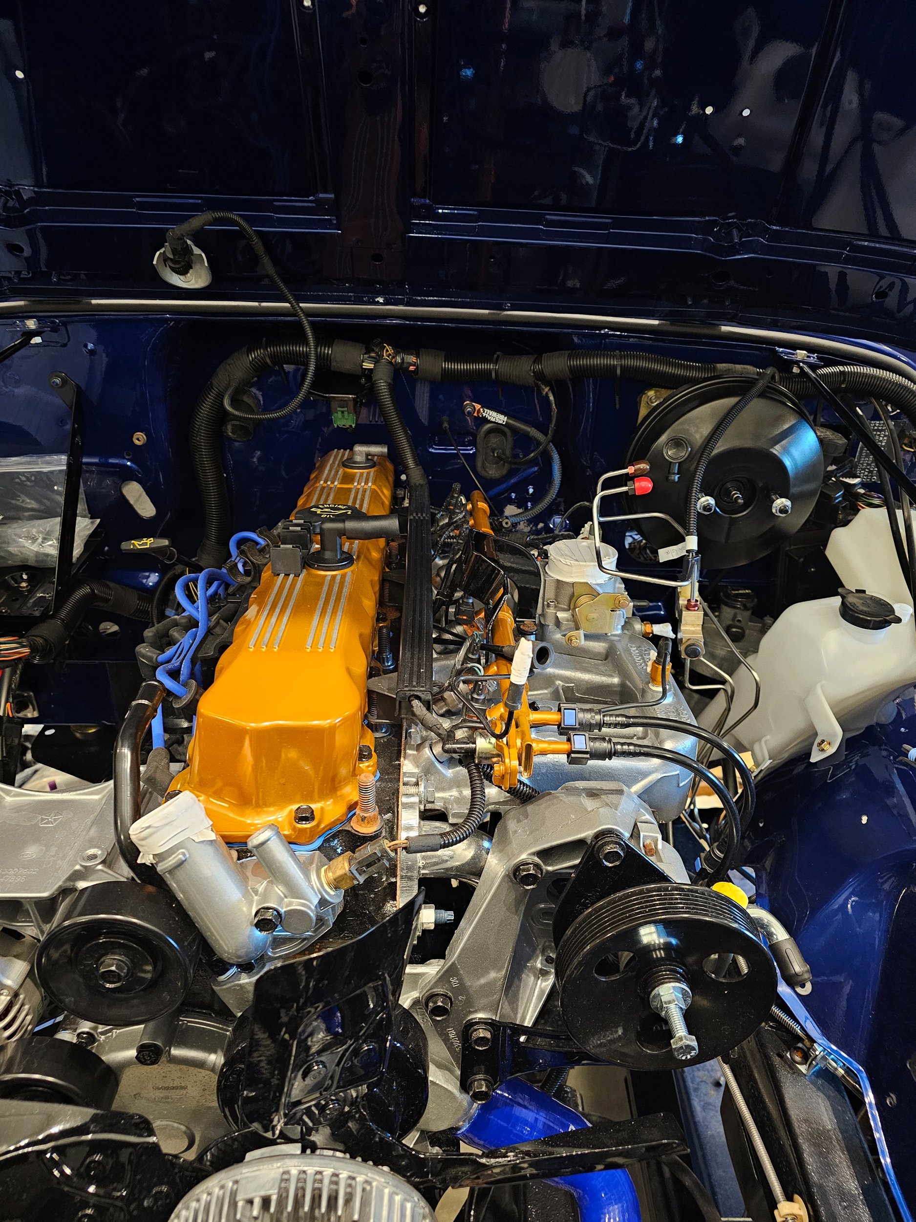

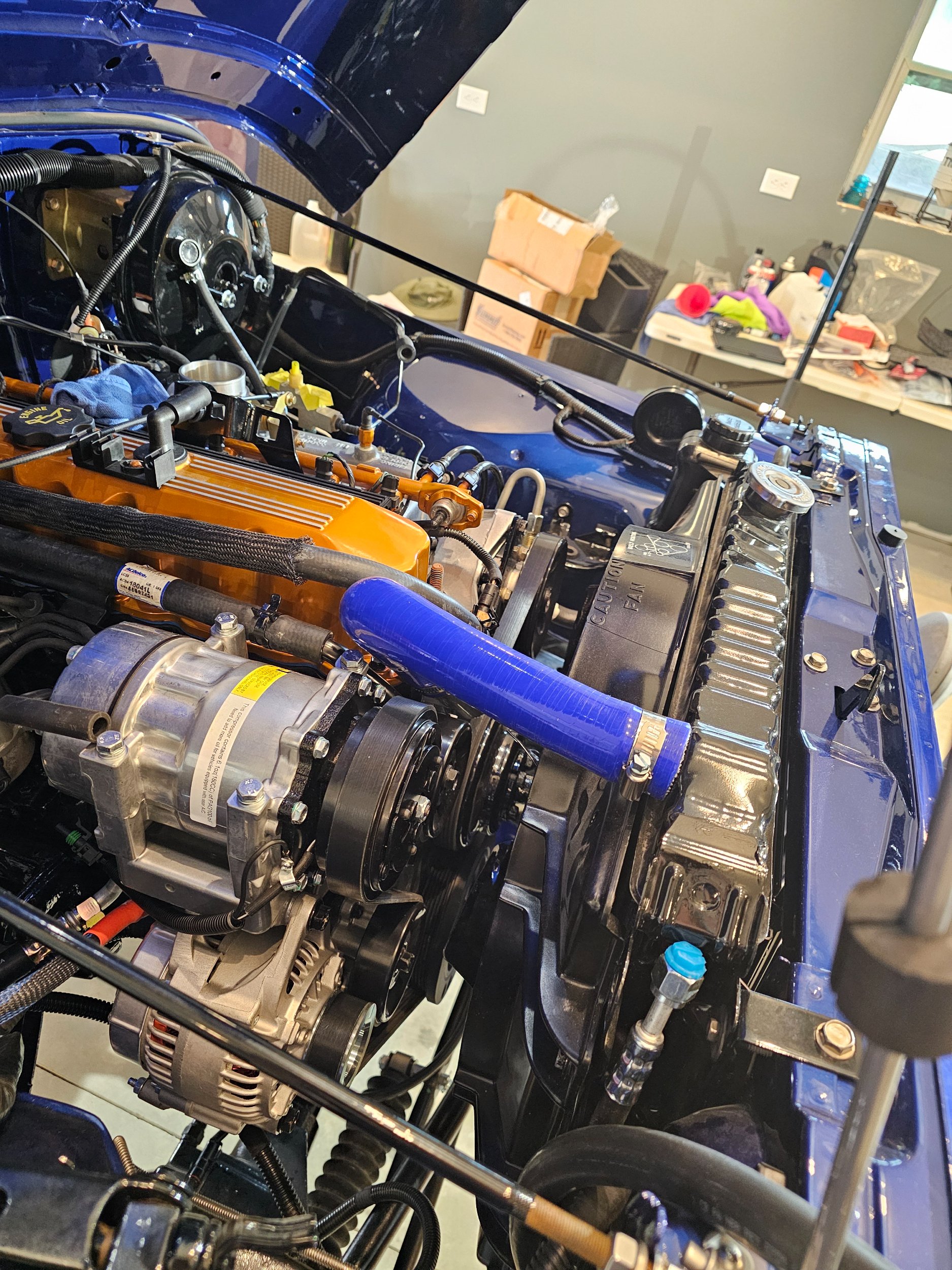

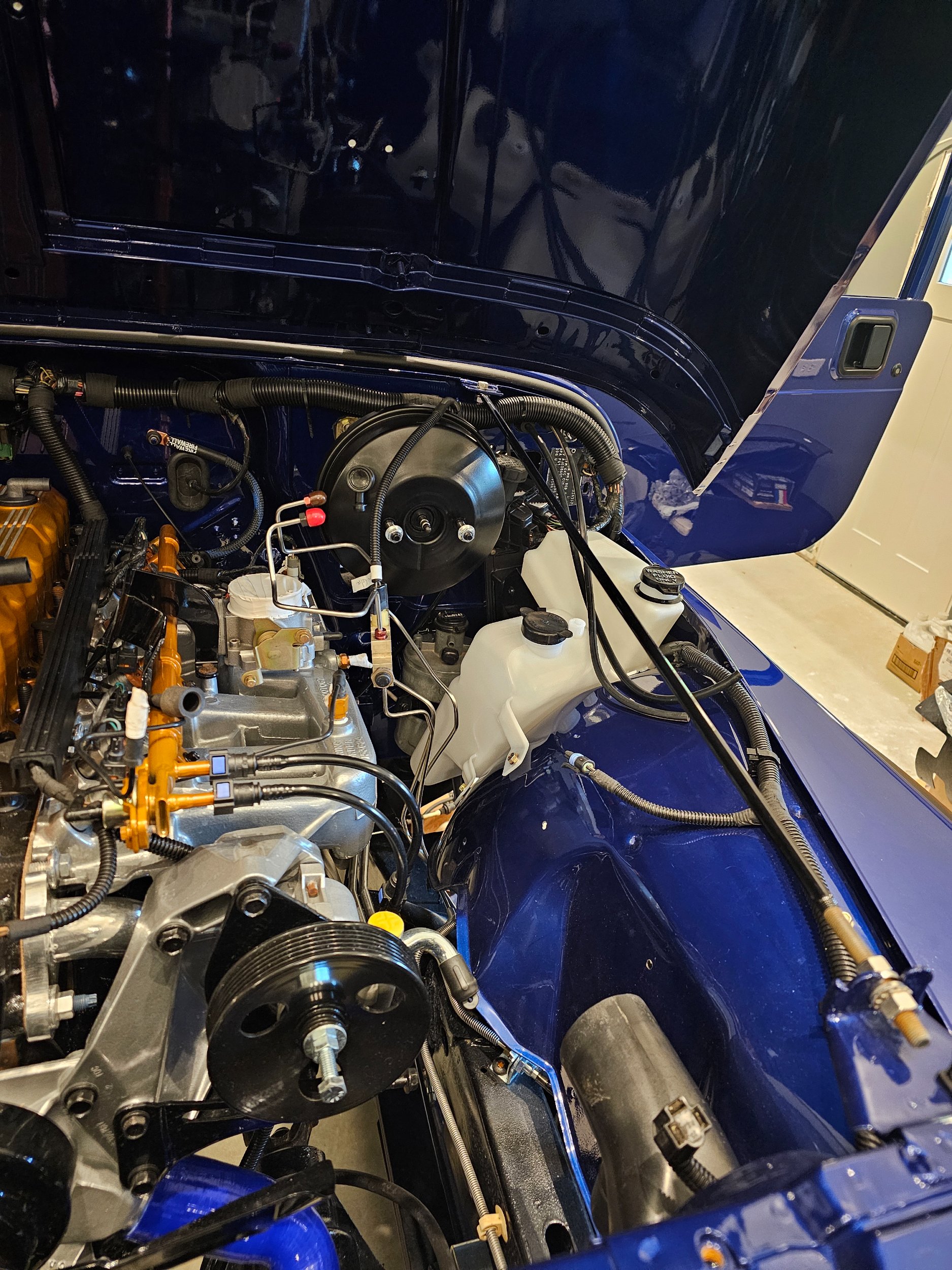

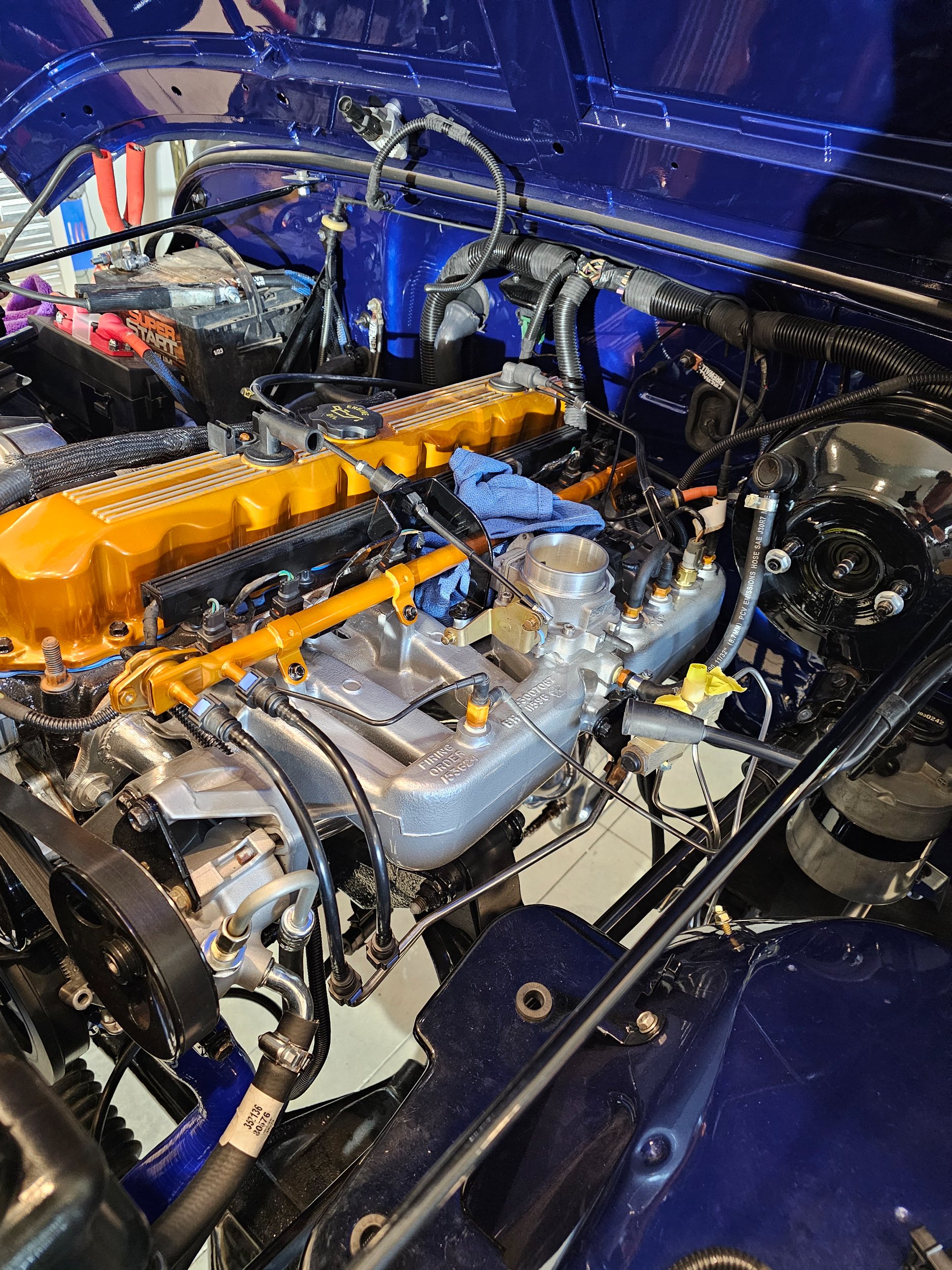

what brand of plugs are you using? is there a chance that you could takes some photos of eng bay and post, maybe we can spot something that might help, with all the hard work that you done, it got to be thing simple that is missed?
Since that picture I have installed belt and radiator
The only thing that comes to mind is you might have a weak coil. Since it is not firing on starting fluid or gas, maybe the spark is too weak.
