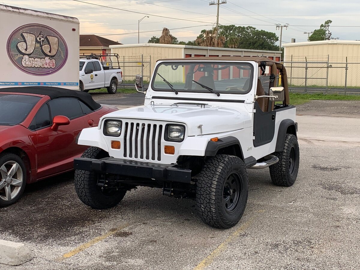

‘93 YJ work in process
Whiplash2130
Jul 16, 2020
150
Florida
Tires (x5) Falken Wildpeak 255/70R/16XL. A/T3
Wheels (x5) AR 172 BLK
Mount and Balance (x5)
Wheel Spline Kit
Valve Cover Gasket
Spring and U-Bolt Kit with 4 Corner Shackles
Shocks (x4)
Track Bar Front
Track Bar Rear
Sway Bar Link Kit
Sway Bar Bushings
Engine Mounts (x2)
Transmission Mount
Ring and Pinion Set (4.10) Rear
Rear End Carrier
Brake Master Cylinder Rebuild Kit
Front Brakes (including calipers)
Rear Brakes (including drums)
Complete Exhaust System
Complete set of Body Bushings and Hardware
Rear Drive Shaft Universal Joint
Transfer Case Output Shaft Seal
Towing Harness
Back in the shop today to evaluate what shift linkage/brackets are needed for the transfer case to make it shift properly.
Other planneD work: New Soft Top, LED Head and Tail Lights, and a new Stereo.
Looks nice. I'll bet the transfer case shifter probably needs a new rubber isolator and locking clip which stiffens up the shifter stick to the shifter base. Takes out virtually all the slop. I've never seen any other issues with the shifters.
Reactions: Whiplash2130
The mechanic told me last week that the bracket was the wrong one. I’ll see what he does about it.
As for the tires and wheels, you’re right about those. They are great!
That's weird. The bracket mounts to the trans so there are different brackets for auto and manual, 4.0 and 2.5. 4 different brackets total if I remember right. No clue why the PO would have ever changed it on you, you should be able to find one on eBay.

My YJ was delivered with a AX-5 transmission from the factory and at some point was changed to the AX-15 5 speed manual. That explains the wrong bracket. The shop is going to get the proper bracket (at a reasonable price they say) install and rig. Still waiting.

Ok! We can add the following additional work as of today:
Replaced Rear Main Seal
Replaced Transfer Case Shifter and bracket - re-rigged. Now have 4WD!
Replaced Oil Pressure Sensor
Replaced Oil Pan and Gasket
New seats should arrive next week.
