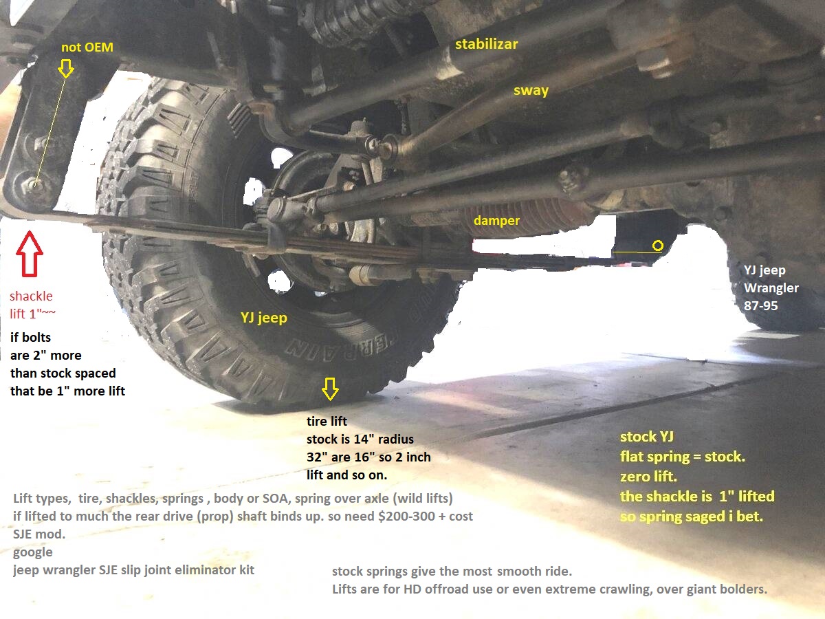

we can not see under you car (blind) to see things missing or wrong or bad /worn. sorry can't post photos off alt things under car.

see this?
the leaf springs day 1 new and there bushings were tight ,new car. ( and do/did not flop about)
after 30 years, they go loose as a goose and flop left and right , (a danger) the track rod was removed (was it?)_ and the happens,. due to extreme lifts done and the track rod was REMOVED.
same goes for rear, track rod gone, sway marked above.
new spring bushings and tight shackles can be a cure.
