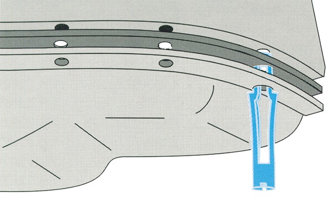

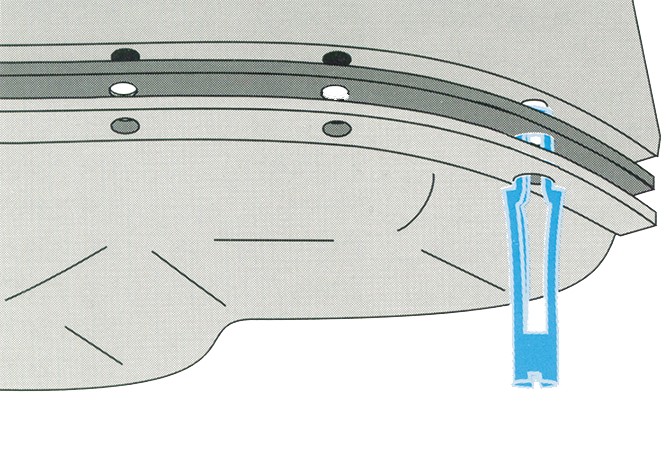

Side note...The nylon "Snap Up" screw in pegs that Fel-Pro included with the pan gasket made positioning both the gasket AND pan a snap, By myself and from underneath with both junked out shoulders giving me hell, Had both of them positioned and bolts started inside of five minutes! Whom ever thought this up is a F'n genius!!
