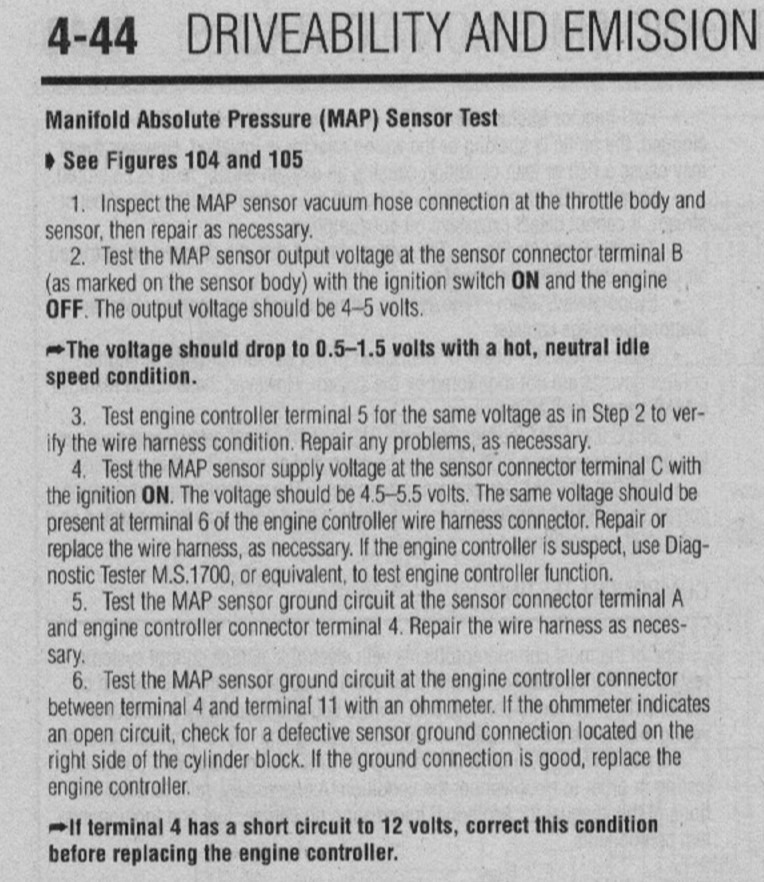

I did replace it with a new one and I did use a voltmeter and got the 5 volts but I couldn’t find my vacuum pump. I need to find it so I can test that. Should it go down to 0 or that 1.8v?
This might help, it's from the Chiltons Manual
