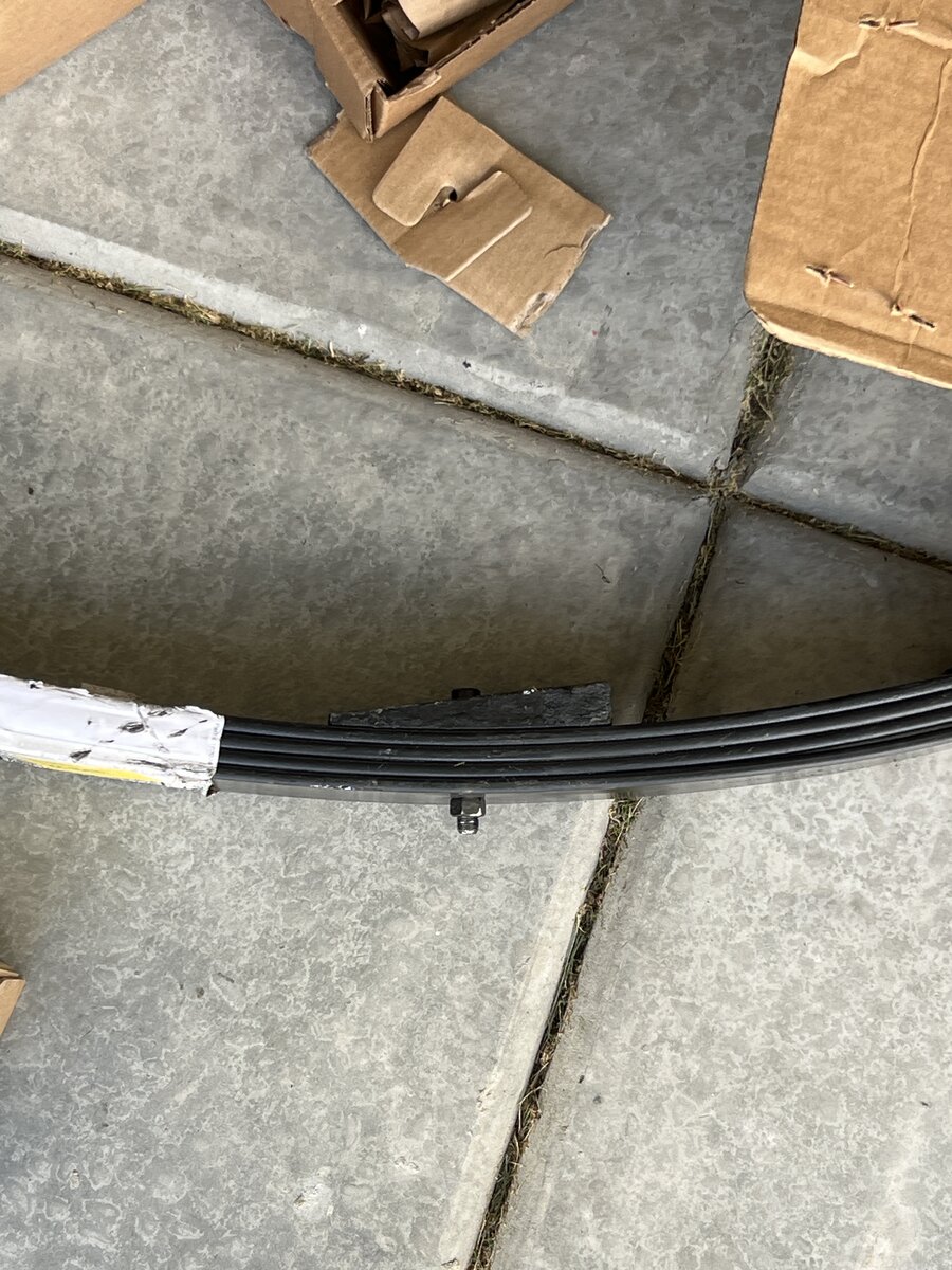

What is this on my leaf spring? Are front and rear the same?

Idk what this thing is on my rear also that’s only way I know it’s a rear.
That is shim to adjust the pinion angle. This is the easier way to do it as opposed to changing the spring perches themselves.

The difference between front and rear leafs on a yj is the number of leaves. It depends on accessories such as winch, hardtop etc to determine how heavy of a spring pack you need.

the shims set 2 things, caster front and pinion angle.(both ends)
and what to do varies by lift height, stock springs, zero lift, and more , after market springs.
do not run 0 caster, in front ever, 6 is natural up front. for safe steering.
mine are 2" lift new springs. (and)
zero shims front and The welded on C to C knuckles are 6 degr factory set (hard) front.
and the rear springs new,had small shims in the kit, that tilts axle pinion up just a tad.
the factory car has a choices of leafs. based on things like snow plow option and more. as Pman sad so clear.
what you have are going to do , not told.
