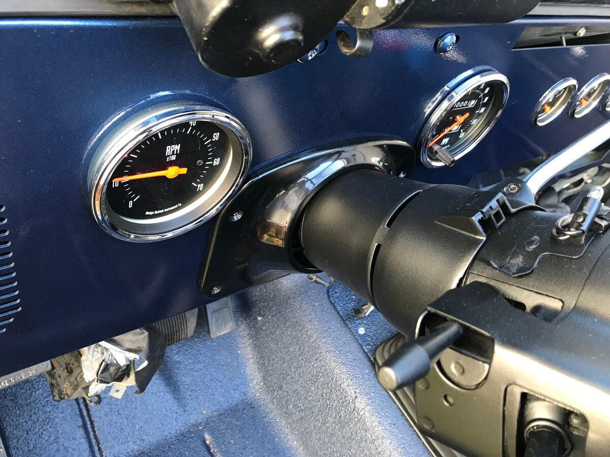

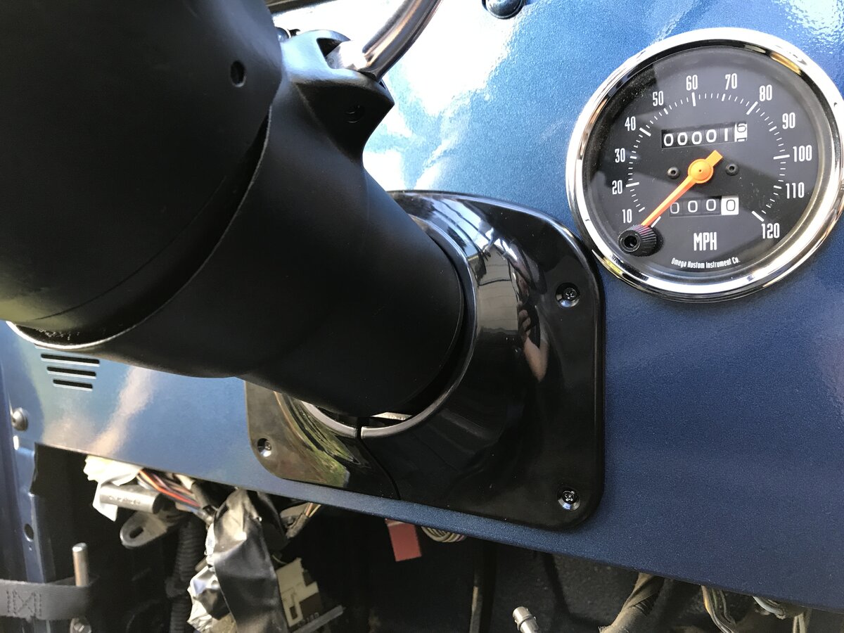

I think you're right, to keep it on there. I 'll just have to cut out the dashboard to make it fit. Will post pics when it's done. Thanks a ton for your help
That dash is beautiful, don't cut it if you don't have to.
Try drilling the pins first, may not work, but it's worth a shot...Just an idea.

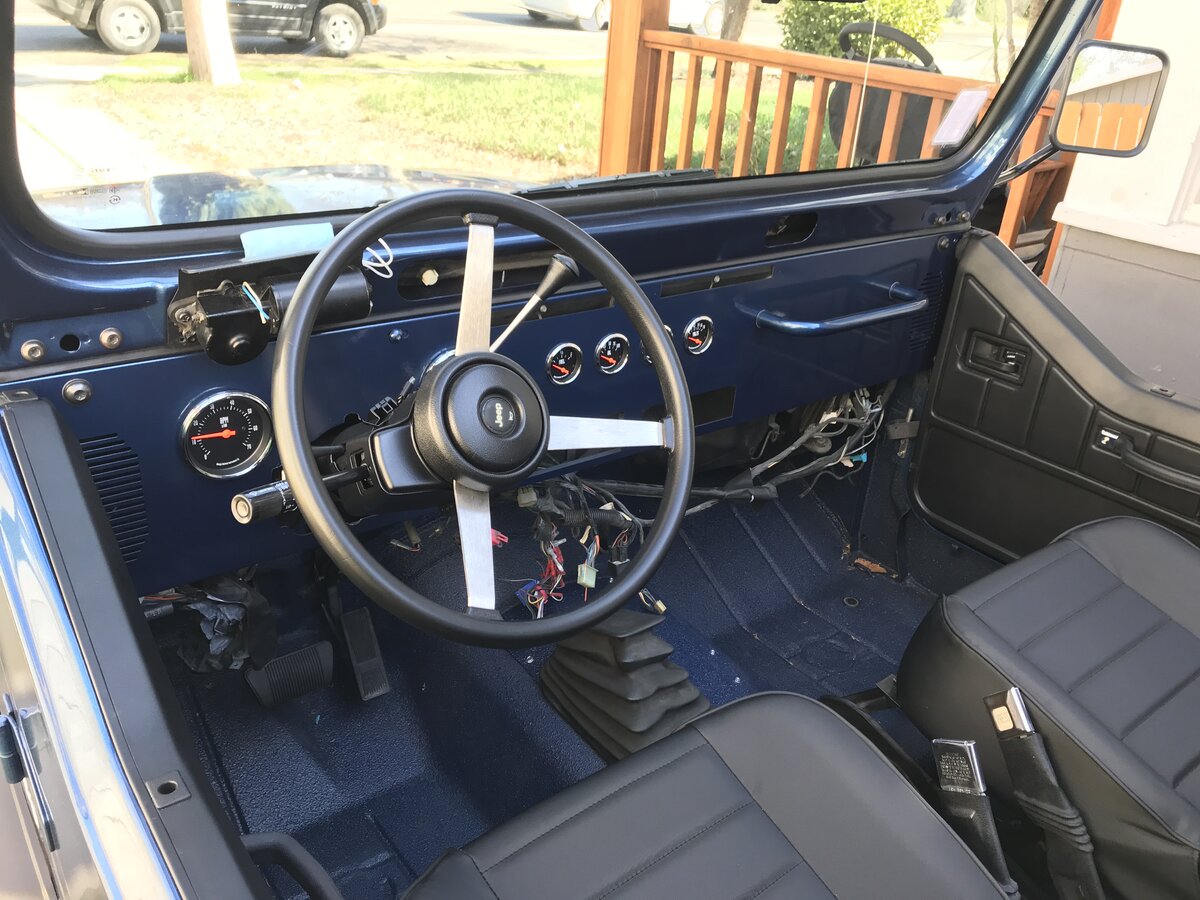

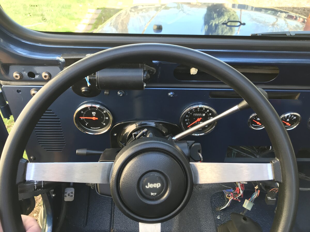

Y'know, I ended up doing cutting it since I did want to keep the device on for the future. It actually came out great, and I have this Steering Column cover which will mask it. It came out a lot better than I thought. Pictures soon
Huge thanks to you guys who posted and did the research, I ended up keeping the security device on and cutting a little off the dash to slip it over the column.
Once that bib went on it came out prefect.
