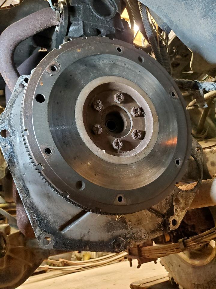

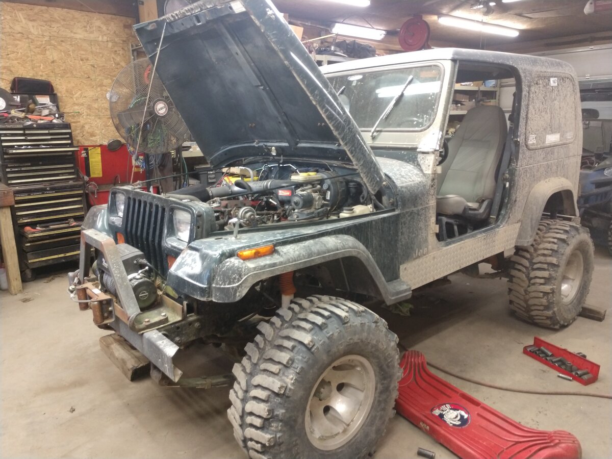

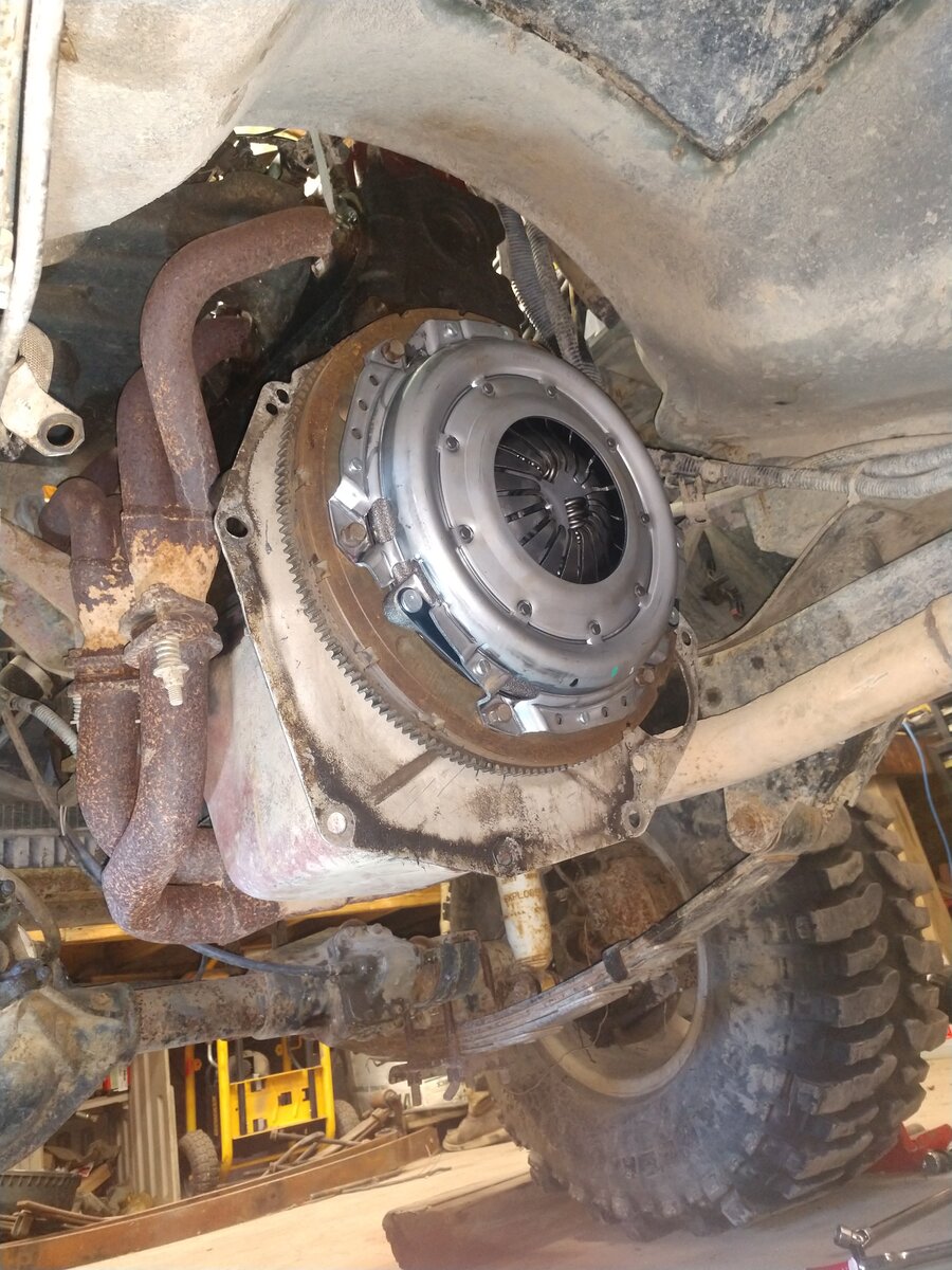

1993 YJ with 4.0 5 speed manual. I changed all the fluids, fuel pump injectors, clutch and seems like there is a slip/squeal. What should I inspect next or how can I tell what the problem might be. Could it be slipping on the flywheel?
The new clutch looks nice. Did you change the throw-out bearing and/or clutch slave cylinder? I once had a throw-out bearing go bad and it squealed whenever the clutch pedal was depressed.
Thanks for the reply, yes I changed the throw out bearing it was locked up also. After running it for a while figured out it had nothing to do with the clutch it was the cold air intake which I thought was weird. Thanks again for replying 😉

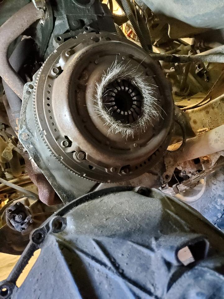

I was reminded of the crude remark guys often make... thinking maybe that really did make it easy to get the input shaft lined up.
OMG! Glad someone else here has my crude sense of humor...I laughed so hard I was in tears!
I've only just now caught my breath enough to type a reply!
That HAD to be a WTF moment when trans came out!
