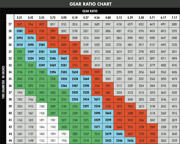

If you're interested the math is as follows, this will initially be calculating for 60MPH, but will be further extrapolated.
Determine the circumference of the tire, Diameter x Pi (3.14), not going be exact but will get you in the ballpark.
That's how many inches it has to roll for one revolution.
There are 63,360" in a mile (5280' x 12).
Divide that by your tire circumference to get wheel revolutions per mile.
Since 60MPH is one mile per minute, it is conveniently also going be the wheel RPM.
Multiply that number by your gear ratio and that's your engine RPM (assuming 1:1 4th gear, no overdrive).
Vary the gear ratio to get into the RPM range your looking for.
Divide the engine RPM x 60 and you'll get a factor you can multiply by what ever MPH you want to determine engine RPM at that speed.
I have 2.5 on 32" tires w/4.88s, my multiplication factor is 51, a stock YJ on 27s w/4.10s is the same, perfect match (on paper).

We can't exactly answer that for you without more info. Between three different gear ratios from the factory, as well as two different stock tire sizes, we need more info. Stock tires were 27's (205) or 28's (215), which do you have? 35's usually measure around 33-34" actual so RPM will be 21% lower on a Jeep that had 205s and 18% lower on a Jeep that had 215s stock. So do the math using those percentages to figure it out. Or, a better way is to figure out your stock gears, your stock tire size, enter them into Grimmjeeper's calculator and then do comparisons leaving everything the same except for the tire size.

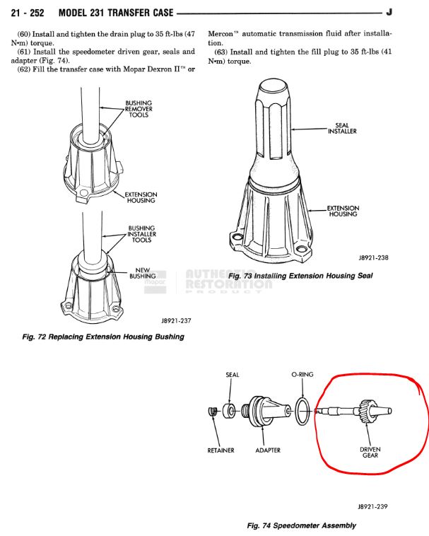

the speedo in dash is matched (ask how) to the actual axle ratio (pinion /ring) in car. (mine has VSS plastic gear sets for axle choices)

or this ,speedo 88 is gear driven cable cluster gauge.

speedo cable fits left and the gear plastic sold in sizes.(ratios)
