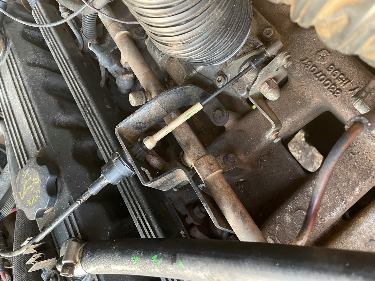

hey guys i just bought a 91 yj 4.0. after doing a look over on it, i noticed it appears to be missing the throttle return spring. i have searched google and can not find a great picture, so can someone post a pic of the factory throttle body set up with throttle linkage and springs? i have found a few pics of newer tjs but nothing on the yj. i am having a problem with the throttle sticking wide open even when peddle is not to the floor. i have to stop and flip throttle back down by hand under the hood. any help or tips would be appreciated.

There is no throttle return spring. Some random TJs had them but YJs and most TJs didn't. You'll get used to the jerky throttle after a while.
As for the throttle sticking, you may need to clean the throttle body of carbon buildup, and lube where the butterfly valve hinges at.
