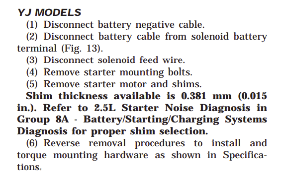

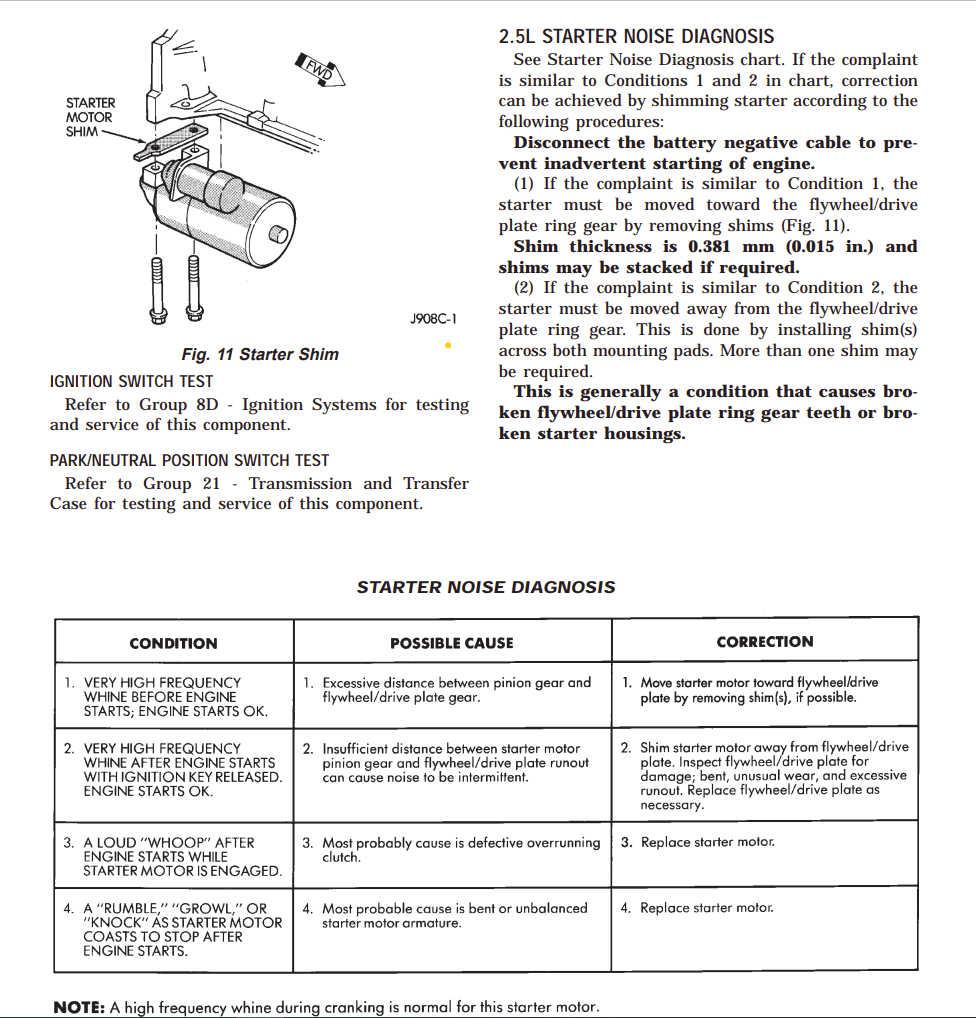

Im helping out a friend replacing the starter his 91/2.5 YJ. It has a rebuild in it now and it has 1 shim. Im familiar with chevy sm's and being able to see the teeth vs valley depth but dont see how this is gonna happen on a 91. Thoughts on how to verify shim(s) or no shim(s) being necessary?
