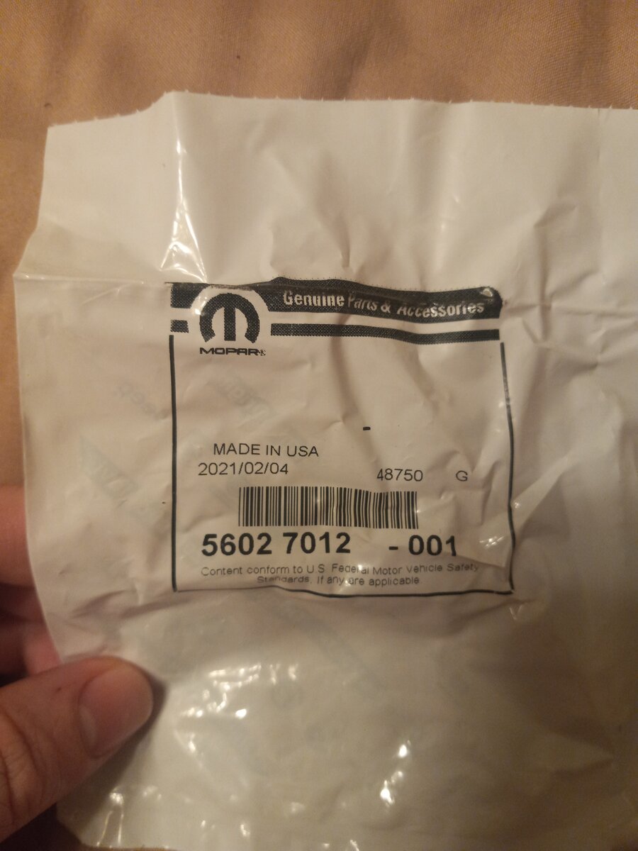

I just replaced the head on my 4.0 and it was running hot, around 235 F.
I replaced the following trying to figure it out:
Temp sender x4
Waterpump x1
Radiator x1
Thermostat x3
I flushed the block and replaced the hoses.
i finally bought a radiator cap with a thermometer in it.
It showed I was running about 155 F at the cap.

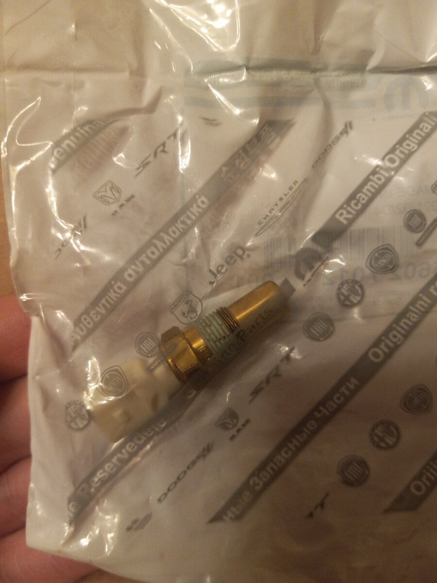

After much searching online, I ordered an OEM temp sender.
That $17 part fixed it.
I bought 2 senders from NAPA, 1 from Autozone and 1 from Rockauto.
Thier mistakes cost me over $1000.
