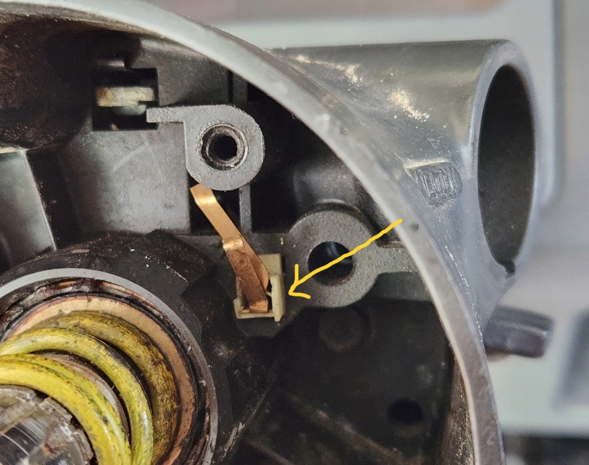

The part I didn't do was remove the key buzzer switch which lead to installation problems while trying to slide the new tumbler in and once in the key wouldn't turn. While messing with the switch removal I ended up breaking off one of the buzzer switch contacts.
In doing my research, it looks like the function of the buzzer switch is a reminder that the key is in the ignition. This never worked as far as I know so it must have been unplugged at some point.
So after breaking the switch I decided to leave the switch out and put it all back together. The new key and tumbler works good as new, the steering locks, all is good... until I hooked up the batter and turned the key. Nothing, no lights, no starter, nothing. The headlights work, so the new battery is good. Ran when parked.
Here's my question: Is that buzzer switch required to start the engine? Again all I find is it controls the buzzer, nothing to do with the ignition wiring.
My guess is I pulled out a wire somewhere at the base of the steering column as I was moving the turn signal switch.
Any other ideas?
Thanks, Cheers.
Update about the buzzer switch. It only controls the buzzer and has nothing to do with the ignition circuit.
