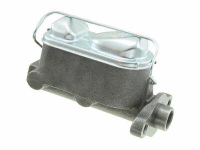

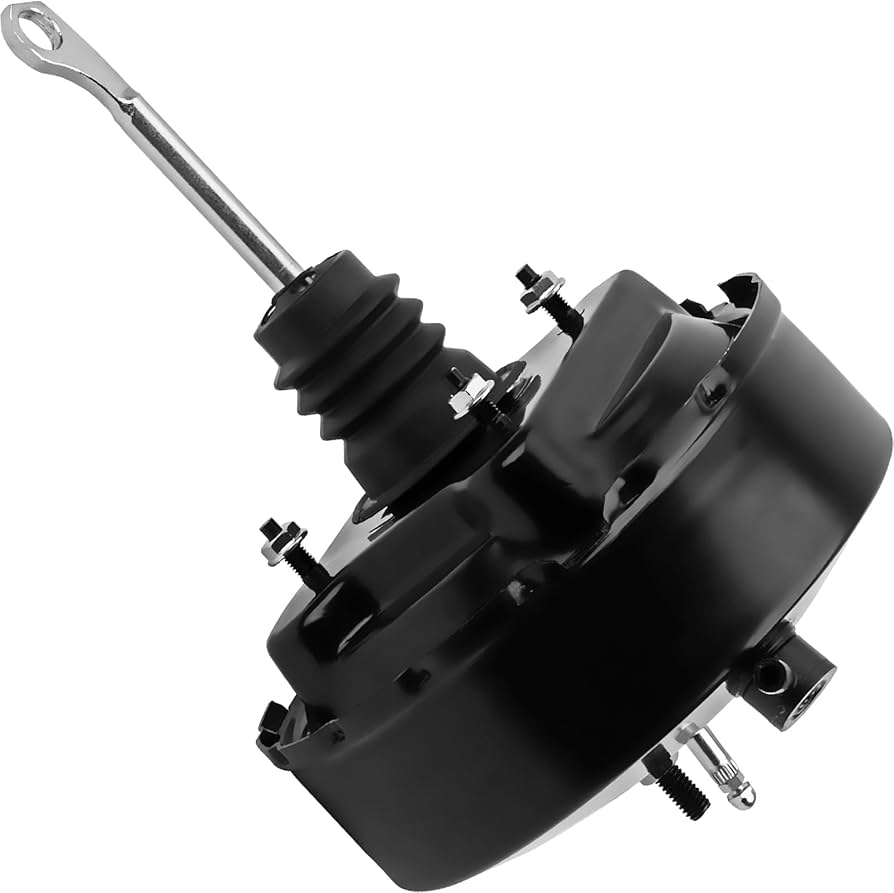

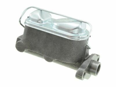

There might be some confusion between master and booster here. The booster is what receives a vacuum supply and boosts the fluid pressure on the brake system. The master cylinder is what pushes the actual fluid through the system.
The booster is what requires X amount of vacuum to function. Without enough vacuum, the pedal will be rock hard and you will struggle to press the pedal hard enough to stop.
Spongy feel is a bad master cylinder. Vacuum or lack of will not cause a spongy pedal.
Booster:
Master:
Re confirm what part has been replaced twice and the symptoms…it sounds like they are calling the booster a master and don’t realize that they need to change the actual master, rather than the booster that they might think is the master.
