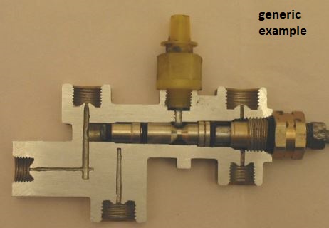

This issue I solved with a phone call to Blaine at Black Magic Brakes. He sold me an inexpensive tool to install in the “proportioning valve “ where the dash brake light plugs in. This salved everything.
solved
once bled, the valve will self centers, with a hard stomp on the brake pedal
then the brake fail lamp goes out. (did it?) /) was it on/?
you bought the bleed tool.
you never said the brake fail lamp glows
the tool just jams up this shuttle valve. (switch out)
the reset is just key on, and push hard the pedal and it self centers if not full of air or jammed.
after sitting for long years the valve corrodes inside and jams up.

I only posted for dead or super weak rear brakes. also 20% rear brakes is common, value for sure stopping fast on dry pavement.
the DOT3 fluid is hydroscopic and wants to rust all these parts out.

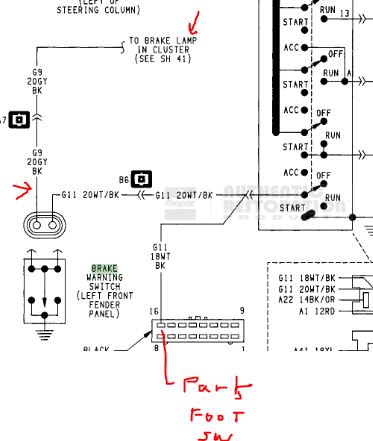

if lamp not glowing key on the lamp good means the valve is in the center. for sure.
the lamp can be tested easy , if suspected
jumper the black pin ground
and cluster lamp glows
here it is, see the 2 pins,
it really is 2 switches inside it not just 1.
the lift switch if for lamp direct
and the other pin sneaks (see the jump) in the parking brake switch.
so jumper ground pin G9 BK (means use the engine ground or battery neg or the body ground)
and the lamp glows, key on
then put back plug, G9/11
and if not glowing in cluster that all is good.
if glows all the time unplug the park brake switch first. key on.

so air in the rear lines
or proportioning valve stuck inside.
i can stick at full on front brakes only if rears have air. that is what it does.
it will unstick if lucky , once all air is gone rear. for sure unsticks engine running and boosted assisted and driver hard braking the pedal.
if not the shuttle piston inside it is rusted up jammed (corrosion)
dismantle and clean it or buy a new valve.
