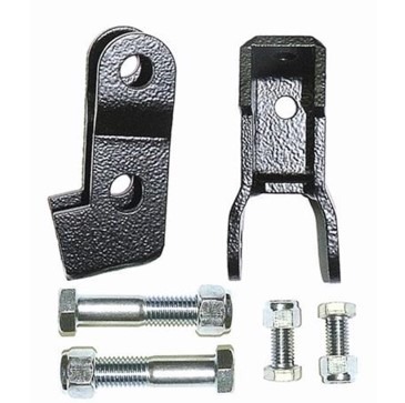

All suppliers of the Rancho RS500X say I will need these for the rear shocks
  • NON-STANDARD QUALIFIER: Requires Aftermarket Shock Adapter Bracket
Can anyone identify just what this adapter bracket is of what it does? For the upper or lower mount? I know the Rancho shock tubes have a wider diameter so maybe it needs the extra clearance but I'm just guessing.

I think this is what they want to get the shock away from the axle housing due to the 5000x being a wider diameter than the OEM shocks.
Rubicon Express Shock Relocation Bracket Bolt-On Rear YJ

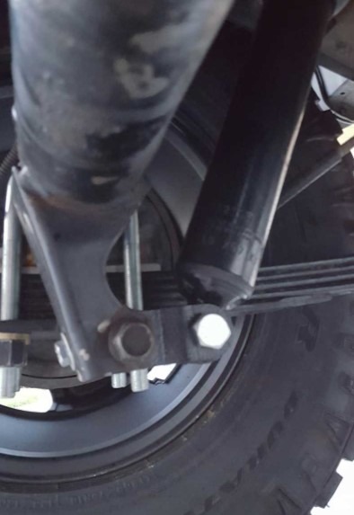

View attachment 118066View attachment 118067
Exactly, you can see how the bracket pushes the shock body away from the axle tube.
As pinion angle goes up, the shock gets closer to the axle tube. Also, the added diameter of some shocks can soak up that distance between the axle tube and shock body.

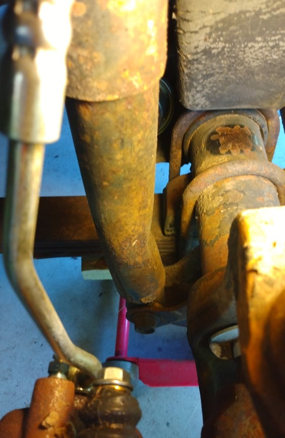

Thanks all. I'm not in a big hurry to change out the original OEM shocks and the new ones will arrive this week. One concern is the lower shock mount breaking as what happened to Gilaguy2 in another post. Reading the reviews about the relocation bracket I found one owner who thinks the offset gave more leverage and more stress to the axle mount causing his to break off.
As a test I may install the rear shock and then jack up one side of the frame to see what the clearance is with the shock fully extended and compressed. I still have the rear track bar out and the wheel travel is now considerably more than with it.

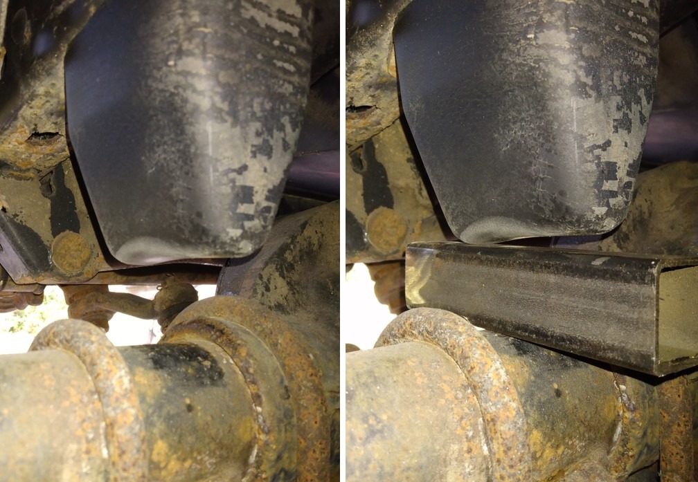

also I found there's barely 1-1/2 inches of travel before the rubber bumper hits the axle housing on both sides with no lift kit. I've used a 1-1/4 in square tube for reference.
Any idea roughly how much space there should be? Time for springs?

As for the bump-stops, not sure what that distance should be, but you've got about an inch more space than I had.
I had all of a 1/2", my springs were SHOT!
Since the 2-1/2" lift, I now have 5" and probably should be putting some spacers in or getting some progressive stops.

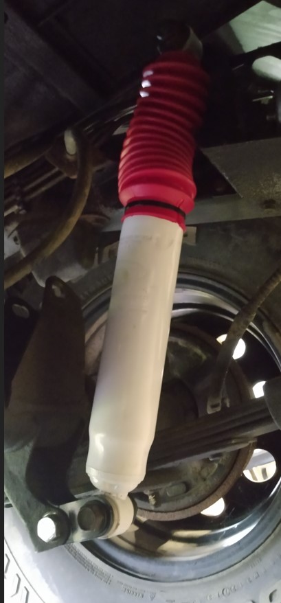

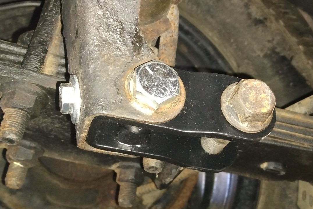

The Rancho shocks and brackets arrived so I just installed everything. All clearances are good now at the top and bottom end. No problem with the fuel filter skid plate space.
What a difference these are compared to the 29 year old OEM shocks. I may have even gained 1/2 inch lift from the 150 psi pressure lol.
Looks good, should work good too, if you're not planning on beating it into submission, like some of us.
