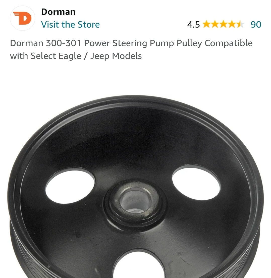

The power steering pulley on mine was plastic and started making a terrible squealing sound. I bought a new pulley on Amazon and that fixed it.
