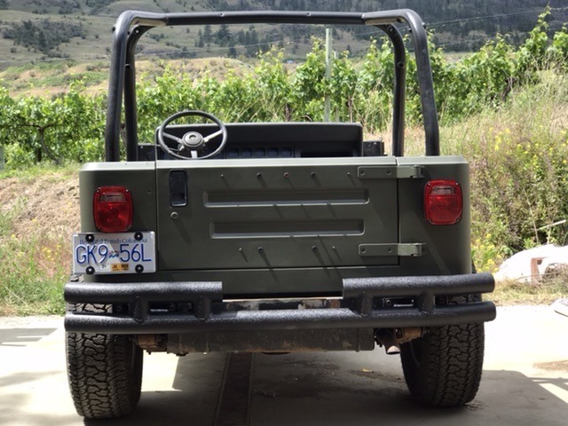

So close on the paint, gotta touch up my touch ups on the sides. Was a little light on the paint in a couple spots and hit em again with my last can that was almost empty. But the dregs weren’t a flat finish anymore so one more coat on the sides of I ever get more paint. What I should have got last Friday looks like I ain’t getting this Friday either. Got a great pile of my interior stuff high on a shelf, all the faded green stuff looking fresh and grey dying to get installed but not til the exteriors finished. But I like the look off the ass end of ‘er. Touch up the gas tank skid plate and bit behind the new bumper when I paint the rest of the frame and stuff. Maybe one day my new springs will show up and I can lose the low rider look

So close on the paint, gotta touch up my touch ups on the sides. Was a little light on the paint in a couple spots and hit em again with my last can that was almost empty. But the dregs weren’t a flat finish anymore so one more coat on the sides of I ever get more paint. What I should have got last Friday looks like I ain’t getting this Friday either. Got a great pile of my interior stuff high on a shelf, all the faded green stuff looking fresh and grey dying to get installed but not til the exteriors finished. But I like the look off the ass end of ‘er. Touch up the gas tank skid plate and bit behind the new bumper when I paint the rest of the frame and stuff. Maybe one day my new springs will show up and I can lose the low rider lookView attachment 115941
That roll bar seems to be doing a great job! ;)
Hope you get your paint, soon. Been looking forward to hearing more about your project, and getting a look at the completed paint job.
