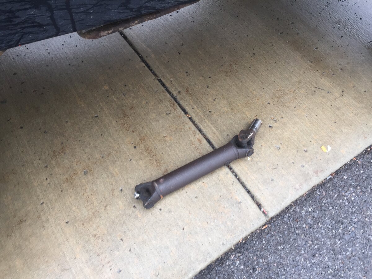

Looks like that’s the least of my problems at the moment. Rear shaft just dropped out... in traffic
Bummer. Hopefully it's not an expensive fix. I'm sure you noticed a lot of fluid on the ground from the transfer case. Be sure to top it off when you get it back together.
Me too. I didn’t see the fluid but I’m sure it’s there. Took a left into busy traffic and pop, there she went. I was able to coast across the street halfway into a parking lot. I’m just glad I didn’t get clipped by on coming traffic
