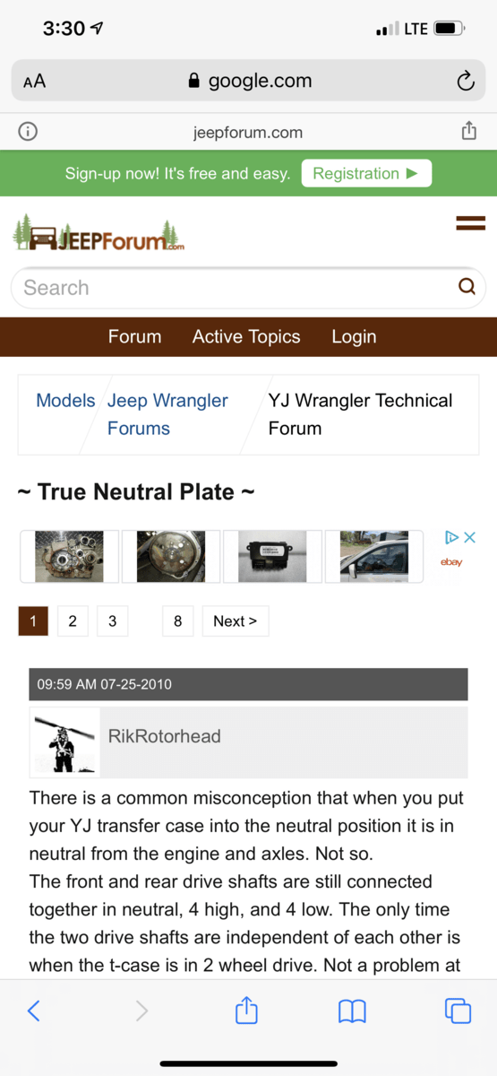

Another of our members pointed out that the sector shaft (the part the shifter is connected to) does not have a true Neutral.
When the T-case is in Neutral, it's actually in 4WD (the front shaft will turn), It's just not connected to the transmission.
But one from TJ does have a true Neutral, try to find that too. There is a link on this forum somewhere.
Really only an issue if you're flat towing it. But since you're there...

I found the thread for the true neutral TJ plate. Here is the P/N for the plate if anyone is interested. Summitracing.com OMX-1867632
