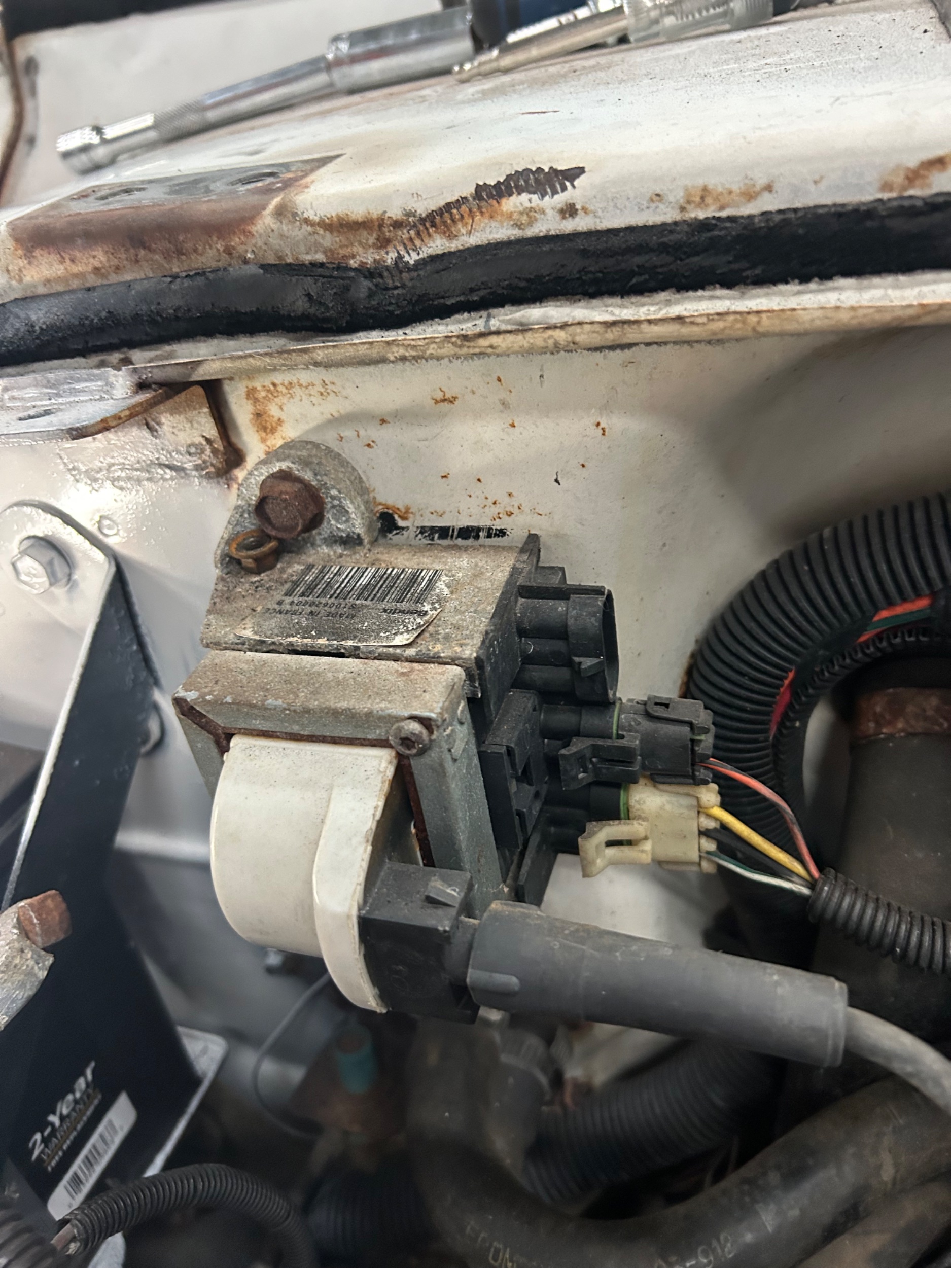

I then turned my attention to the ECU once I finally found it under the passenger-side dash. It appears to back right up to the ignition coil on the firewall. While looking at that area, I noticed there is a plug missing at the top of the ignition coil.
Is that intentional, or am I missing a critical connector that could be causing my no-start issue?

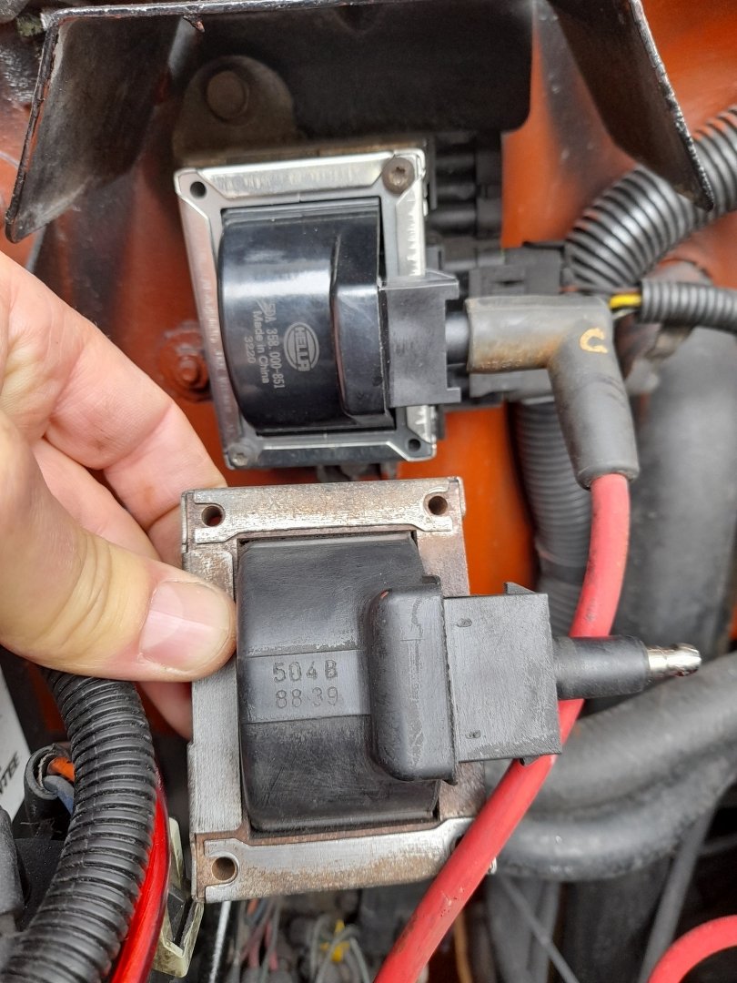

That looks right. Mine is a 2.5l 4pot and also had the plug at the top of the coil module 'missing'.
You can just about see it behind the coil pack. to the right of the top right hex screw on the coil pack.
