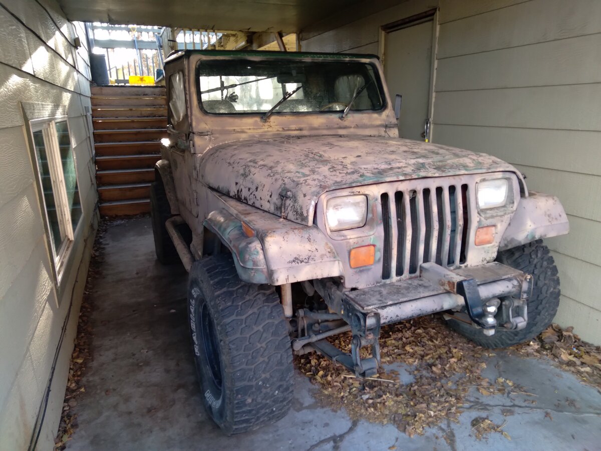

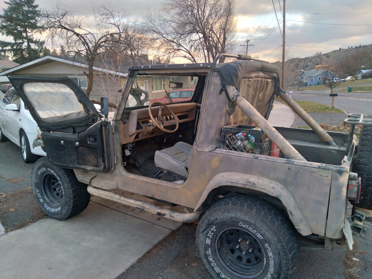

Need a transmission for my 88 4.2
DeltYJ
Nov 15, 2021
24
Klamath Falls Oregon
Transmission wanted any leads on an AX15 blown up I can have rebuilt or t5

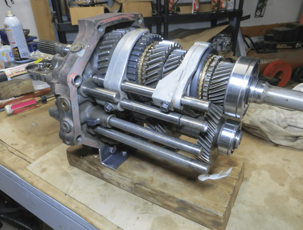

Rebuilding an AX15 is very meticulous but not impossible with a hydraulic press and some basic tools... And YouTube.
I did an AX-5 , first time ever attempting that. A bearing and synchro kit can be less than $200.
The factory service manual is a must have item and covers every step needed.
How long it take you? Still I can't even find one less than $600
I spent an hour or two each day for about two weeks because I had never done this before. After I saw how everything worked i could probably strip one down and reassemble it in a day.
I built a simple stand to secure the center plate during the process which made it much easier.
You'll need a press for getting the gears off the shafts. I bought a $50 snap ring plier set at Harbor Freight which I highly recommend.
Here's a 20 minute video showing the steps. (Not my video but I used it as a guide) Be very careful not to lose any of the locking balls, springs, or small parts that can fly off into orbit. Also take lots of pictures before you take anything apart.
