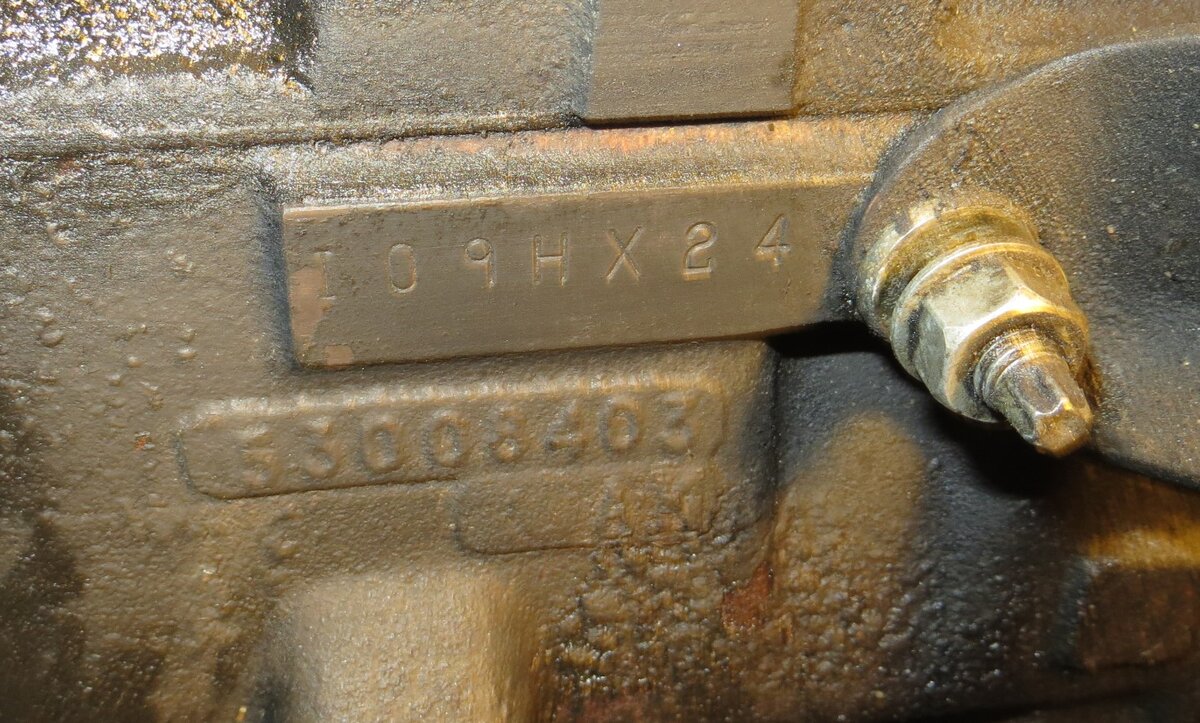

Recently bought a 1992 YJ. VIN shows it came with the 6 cylinder. Prior owner must have blown the 6 cylinder engine, as it now has a 4 cylinder in it, which needs a timing chain (but I digress). I am trying to find out the year of the engine and need a bit of help. Engine code is not between cylinder 2 and 3, as I thought it would be, per the google. The code is under cylinder 4 and says "53008403". Any help deciphering is appreciated. Under cylinder 3 is stamped, "FINB" and three horizontal lines...weird.
Also above the alternator there is a rectangular piece of metal about 7" x 4" with four threaded holes on the corners and the molar symbol on it. It has the following numbers: 53007602 and 47896. Probably not relevant to my question, but thought I would add it.

I think the number you want is the one above the 53008 number. It's by the oil dipstick bracket. You may need to clean it off to read it.
