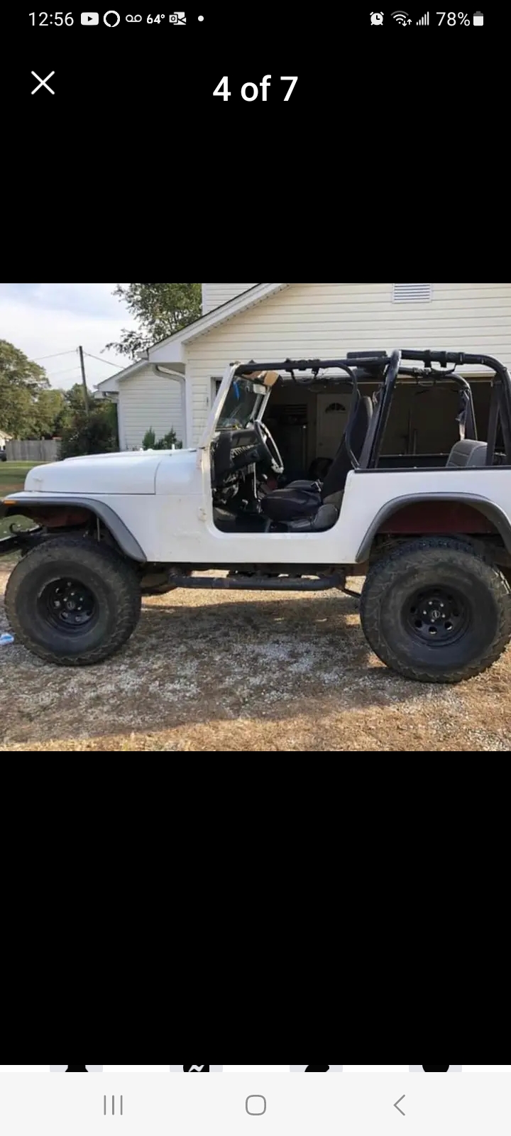

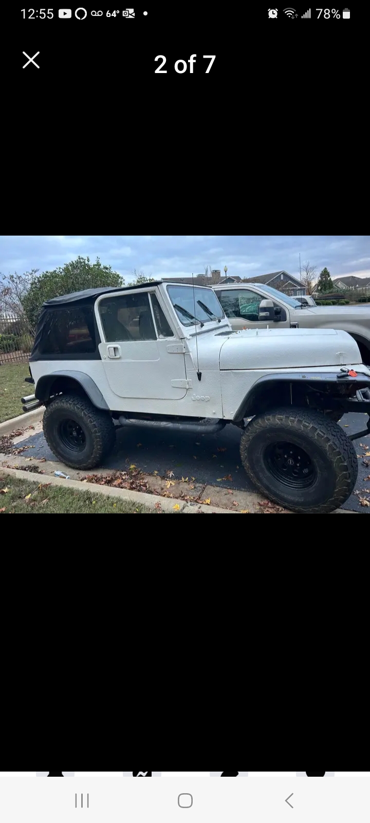

Just picked up a YJ with a 2.5l. Runs great not much power with 35's and a 4 inch lift but everything works. Just found out it has an 8.8 in it. For 2k cash I dont think that was a bad deal.
