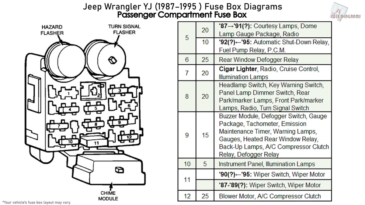

I had this EXACT problem while I had the 2.5 in mine...Check your dome light fuse, Trust me...It took me three months to ferret this out...
Mine is a '95 and my dome fuse also had the following circuits tied to it....Fuel Pump/ECU/Main Shut Down Relay...No shit.
Changed it and she fired right up, After I had the ECU gone through...Have an awesome hook up for that if you need it, New Crank Position sensor...
It all came down to a 10 amp fuse in the #10 slot....Your's appears to be your dash lights, So if your dash lights aren't working I'd start with #5 and #10
I do have issues with the instrument panel (lights flicker and temp gauge is iffy) might be what’s shorting out that circuit.

My fuse panel was easy to get off the firewall....Might need to check the connection to the fuse slot..........
Well, the Jeep didn’t come with a radio standard and someone wired one in. It comes on when you hits the lights…. Willing to bet they put it on that circuit like dumbasses and it’s causing problems.
I worked for Toyota during the advent of EFI....And we got a TON of ECU problems in because people were wiring into any power circuit they could find for lights, Amps etc. And the circuits they tapped into that were ECU sensor power/ground circuits and threw off the "Balance" of the circuit. Causing the ECU to react to what it thought was a problem by reading the change of amperage in said circuit. I'd strip all added wiring as a start and see if that helps.
