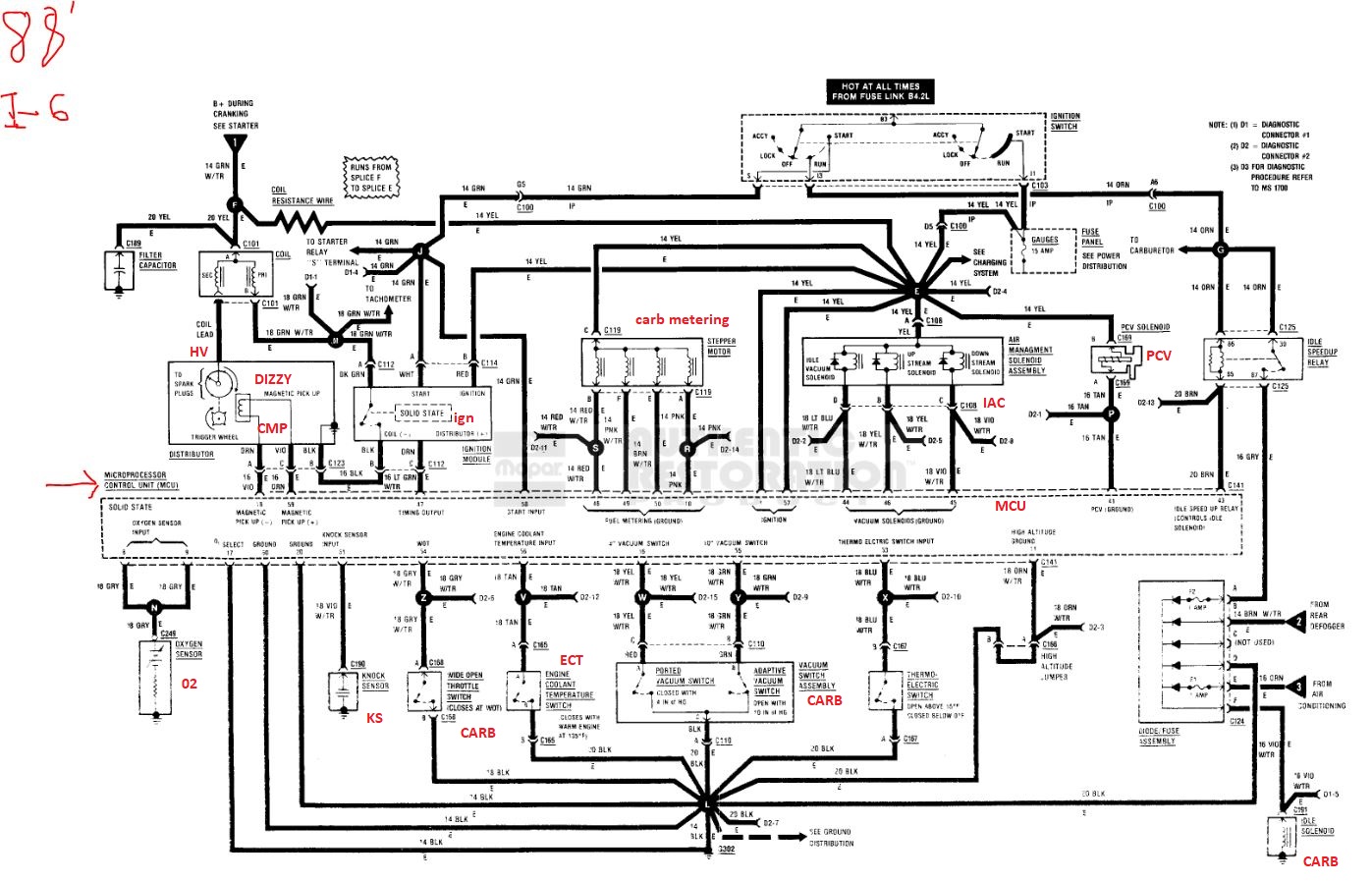

here is the 88 full carb controller schematic. called the BBD 2v carb.,page B-217 in the FSM manual factory service manual.
258cu-in, or 4.23Liters I-6 engines, the vin codes tell you what was there day 1 new. carb code 8384 (manual trans version)
page B218 shows all settings for the carb, for sure choke setting and be sure it released when engine is hot (180f = hot/normal)

The MMC controls all fuel mix when engine is hot (means normal) it does that by modulations of the metering solenoids on side of carb.
and 1 O2 sensor

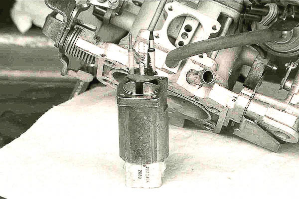

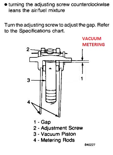

Many of this electric carbs are now modified, and the 1st clue is the missing marked below metering devices.. wires cut to them a huge clue.
Some of this used vacuum metering device photo 2, that love to gum up.
as you can see last photo is the BBD 1987/89 fuel mixture control stepper motor, device, this is how the MMC controls mixture all the time.
most times we see it missing or wires cut to it and vast posts in calif failing dead hard for this device missing or hacked and failing smob for just the visual inspections in CALIF (< posted as a worst case to learn the ropes here)
