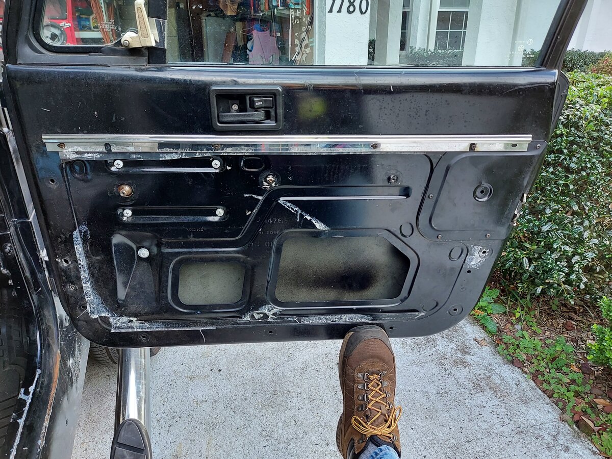

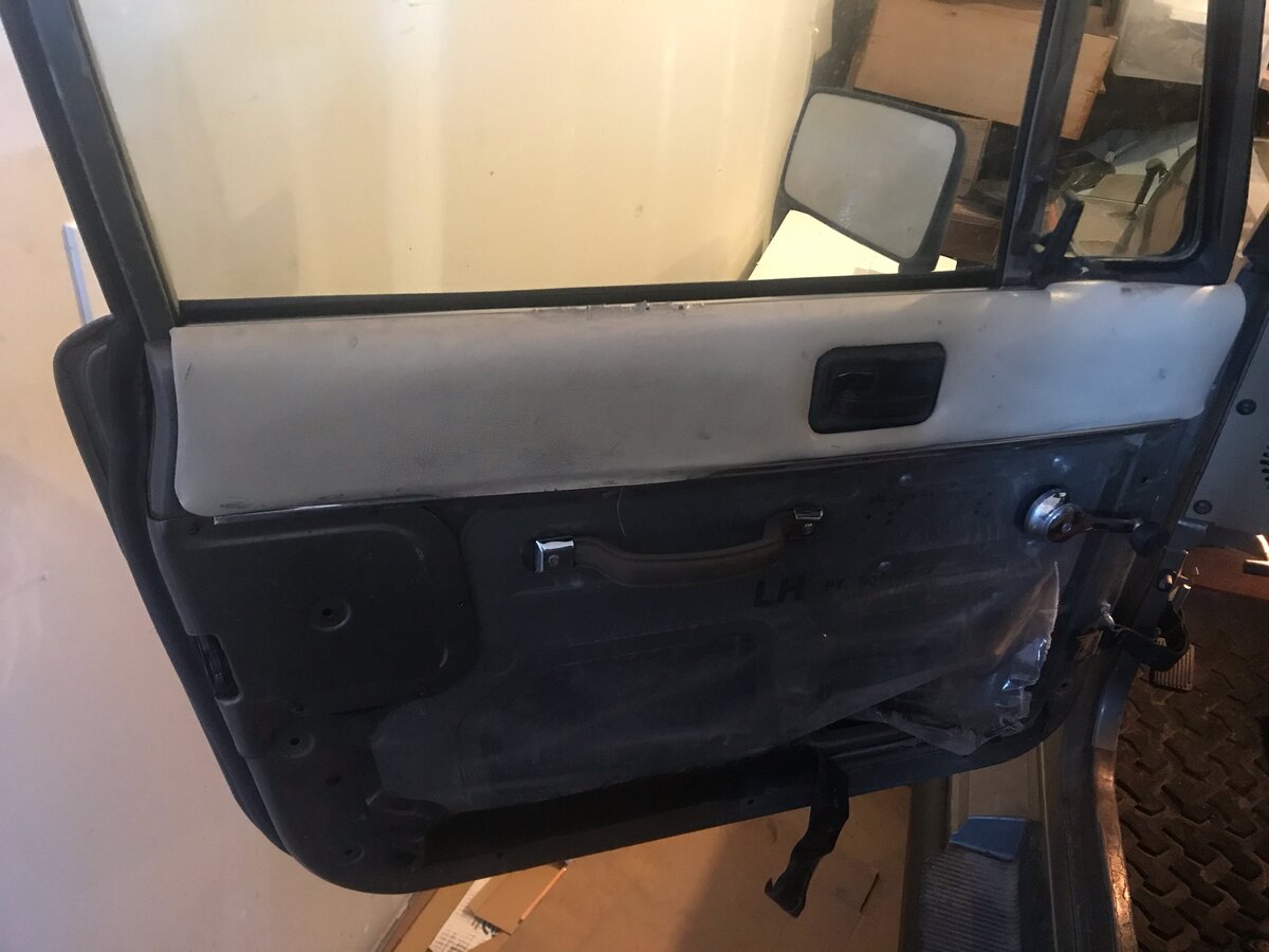

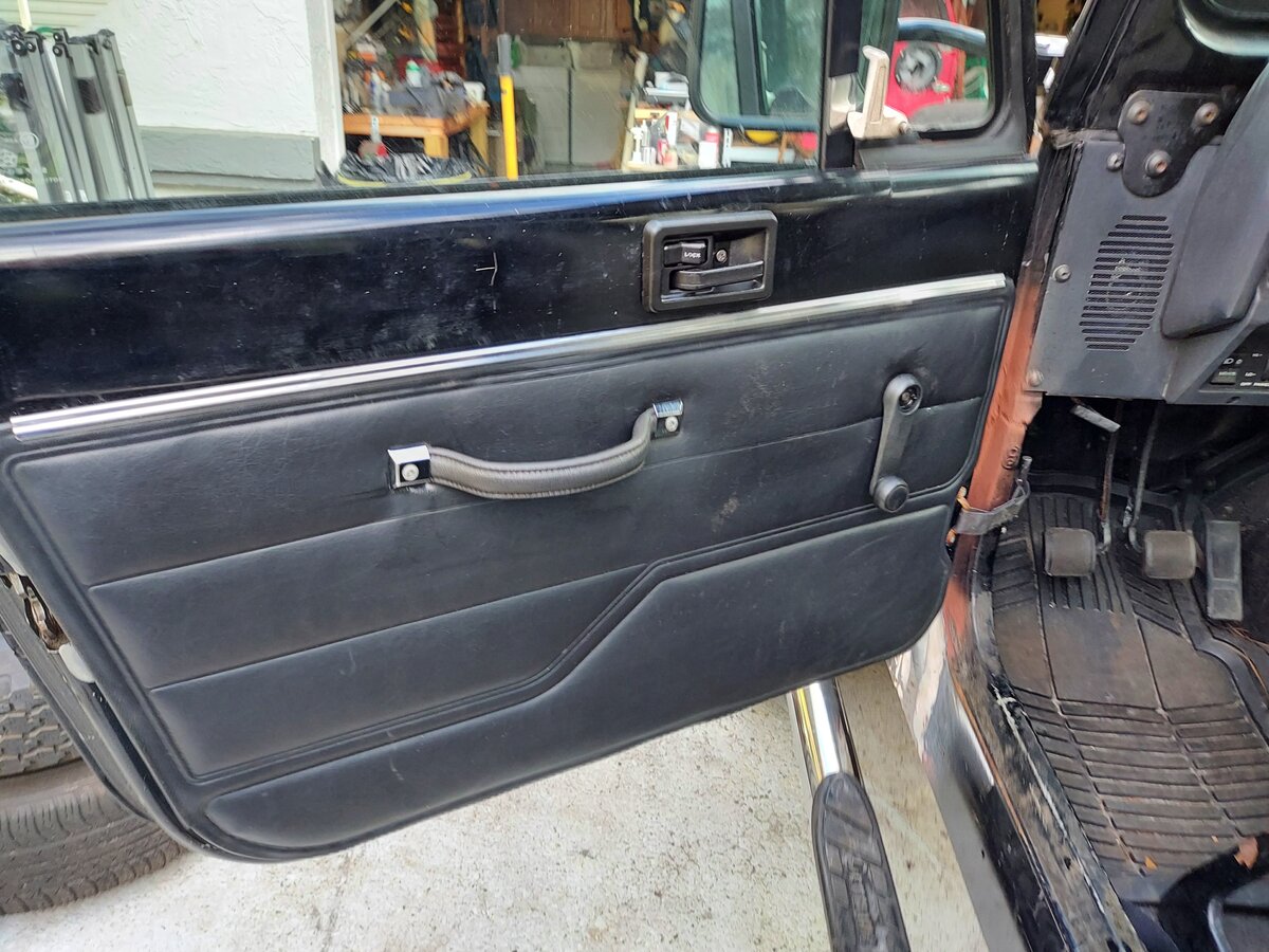

inner dooe lower.jpgupper door liner.jpgI finally got around to pulling off the drivers side, they are two piece. The top covers from the window down and stops just a little before the window crank. I have only seen one other reference to these type of inner liners.

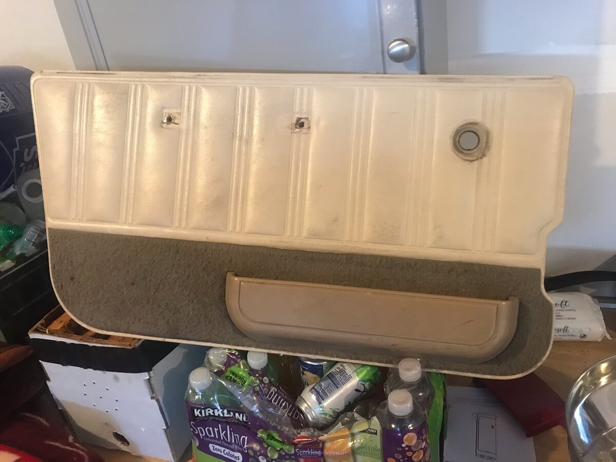

Doesn't help much for you, but thought I would post a couple pic from when I did mine. The cardboard was rotted away. I found what I call "hard board" at lowes. It is pressed cardboard to me and is maybe 3/16 thick. Just cut out the pattern, I added a thin layer of cushion material and re-glued all back together. Also put a few stainless staples on the backside at bottom.
