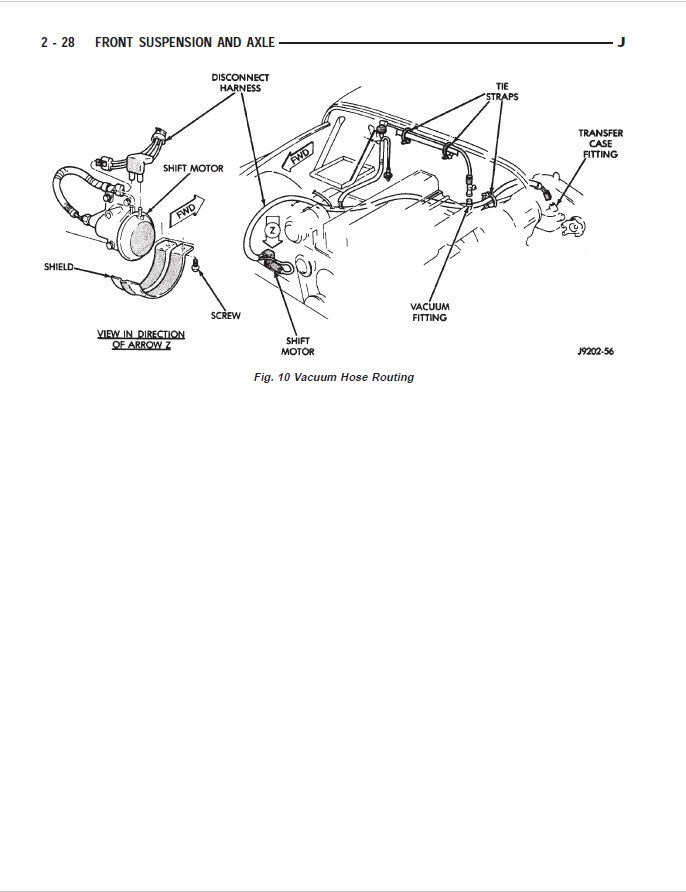

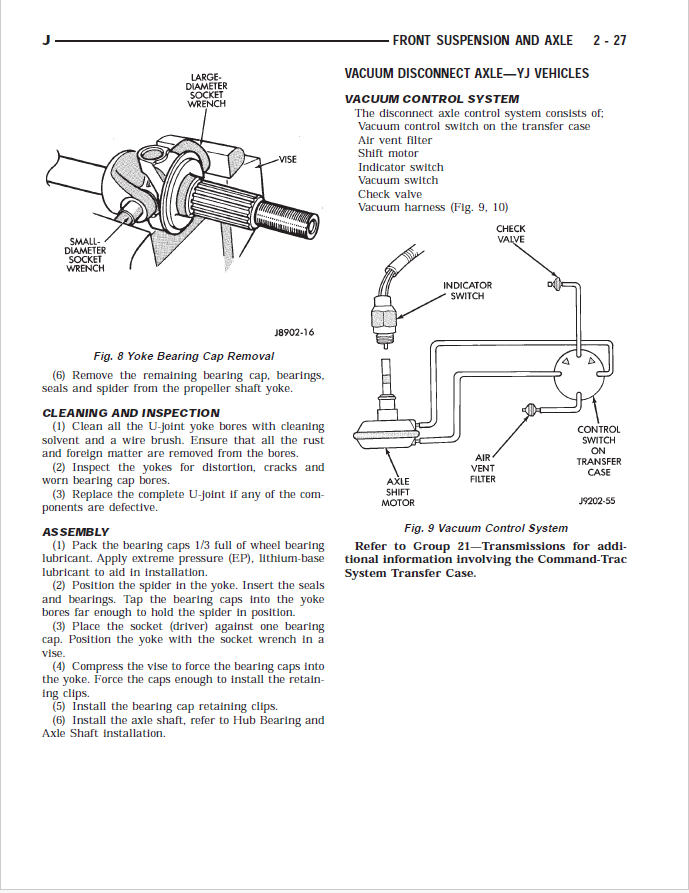

If you are still with me, a question. I took out the 4 tube harness and inspected. All tubes are in great shape. In testing the lines, there is one that leads from 4 prong plug, terminating by the dipstic, drooping down, with a bulb end on it. I feel air leaking out of it when I push air through with a compressor. What is that end for, and should it leak air?
Yes it should do that - it’s a vent. With the engine pulling vacuum, air has to flow into the system somehow. Similar to a plumbing vent.
Great, thank you! Although no vacuum at 2 leads by front axle leave me still stumped. I think I'm defeated.
If you put compressed air on the holes at the 4-port plug that correspond to the axle, can you get any air out of the front? How about if someone plugs the axle end holes with their fingers? Any hissing from the middle of the harness maybe?
It’s bizarre the issue you’re having. Maybe the leads going to the axle touched something hot and melted shut. The exhaust is in the area where the vac harness runs by the transmission. Maybe something happened there.

Aftermarket switches and sensors have always been junk, nowadays, they're even worse than before with the parts shortages. It's highly possible you got a bad one. That dropping part you're talking about is called the "air vent filter", it's connected to one leg of your transfer case vacuum switch. Then two of those legs are connected to the two lines going to the front axle and the other is connected to the vacuum source check valve up in the engine bay.

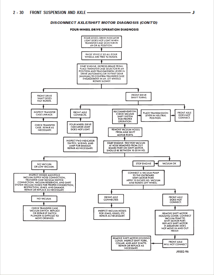

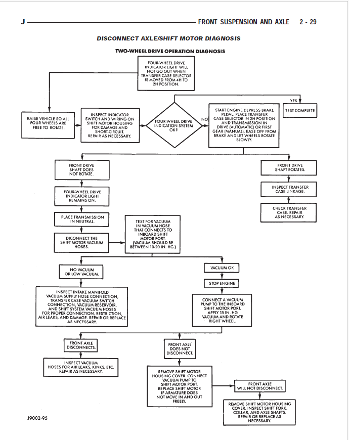

Here's the section from the FSM on how to diagnose that system. Follow that flow chart as best you can. When I worked on military aircraft, those of us that could use these types of troubleshooting guides properly were way ahead of the game when it came to working on stuff. The guys who made these manuals know lots of stuff and did lots of R&D on these things.
