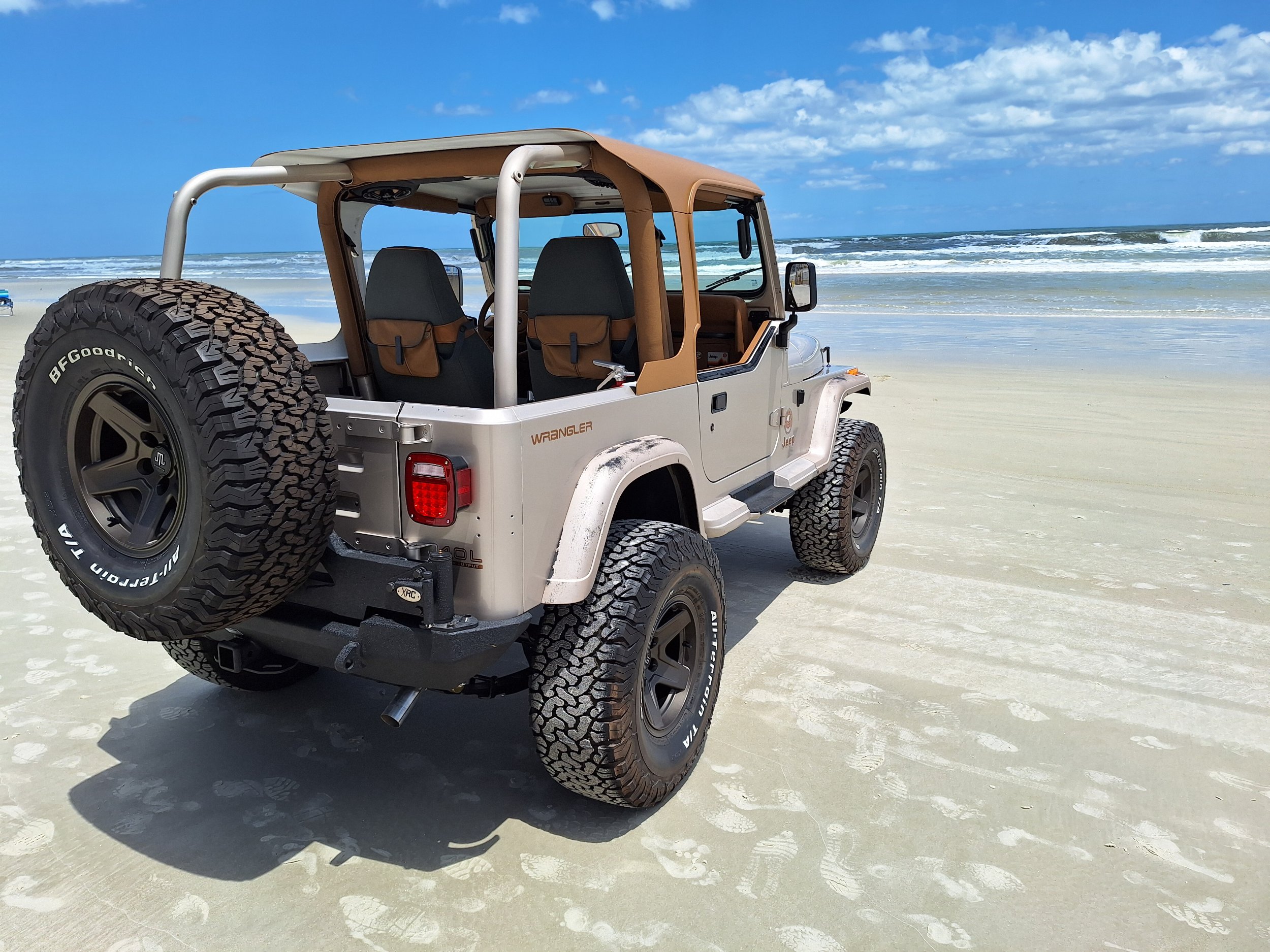

I have a Smittybuilt bumper/swing out tire carrier on my YJ. I knew that mounting a 33 would wreck the tailgate hinges. I was concerned with the tire being mounted up too high so I bought the adjustable version. That allowed me to adjust the mount so that the tire almost sits on the bumper itself and is nice and low on the back of the Jeep, out of my rear view mirror. There are other similar options out there that would do the same. I have been happy with mine so far.
