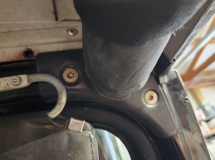

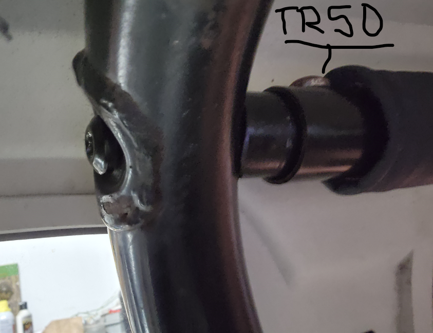

Do you have a hard top or soft? I have the hard top so I found it much easier to remove the adjustable spreader bar section of the roll bar that runs along the top of the windows. Reason being, there's a tamper resistant torx bolt there #TR50 that was difficult to get access to.

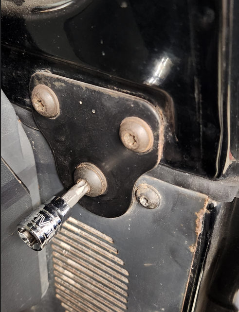

First remove, the three Torx bolts Size 40 on the inside plates near the lower corners of the windshield, there's a plate on each side. The plates have elongated slots for adjustment.

I removed the spreader bar. at the back end where it attaches to the roll bar there one Torx size 50.

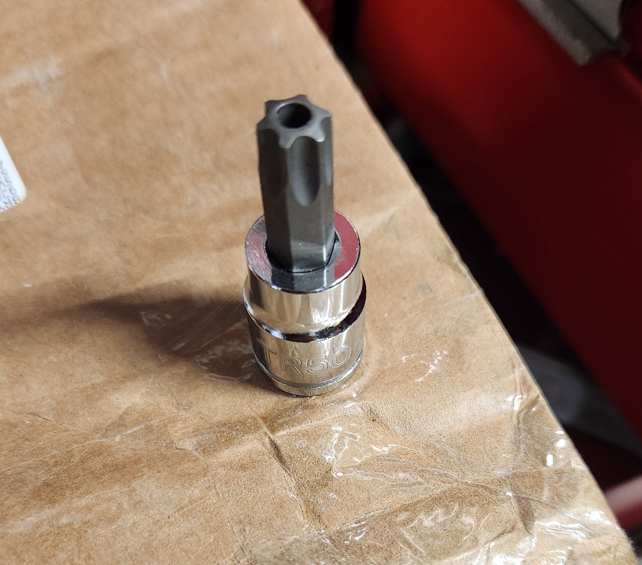

The length of the spreader bar can be adjusted by loosening the special Tamper Resistant Torx bolt TR50.
You can easily find the TR50 at most hardware stores or Amazon for $6.
remove the three Torx size 40 from the front end of the spreader bar where it attaches to the windshield frame upper corners. Sun visor too if you still have it.
