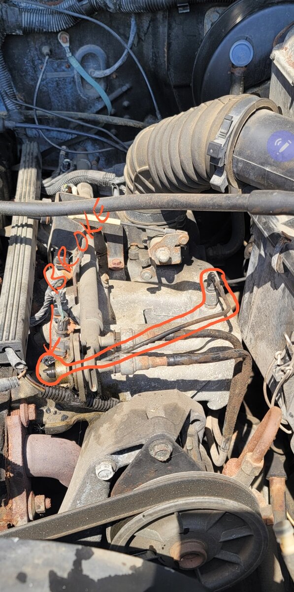

My fuel pressure regulator tube is rotted. What else can I use to replace this tube or does anyone have one? It is a discontinued part
You might try deadjeep.com, FB marketplace or your local wrecking yard.
Do Cherokees use the same part? Those things are broke down all over the countryside.
Reactions: Joeljeep
If all you need is the elbow, most parts stores have a selection.
If the plastic pipe is also bad, you can replace it with rubber vacuum hose.
Somebody had those vacuum harnesses in stock awhile back though. I'll see if I can find it.
Reactions: Joeljeep
