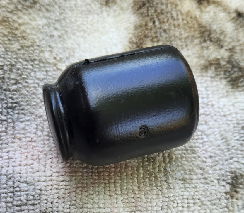

First off, and current problem, I found the plastic float has fuel inside it. I'm looking for just a new float but can't locate one for the YJ. There's plenty out there for the CJ but comments say it doesn't fit the YJ. Any sources you know of? As a last resort I'll poke two holes in it and blow the gas out then give a very light coating of gas proof sealant. The sending unit works fine.

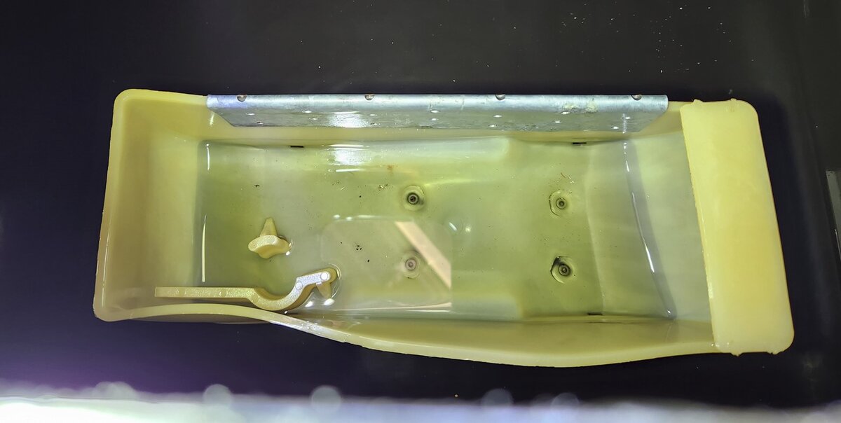

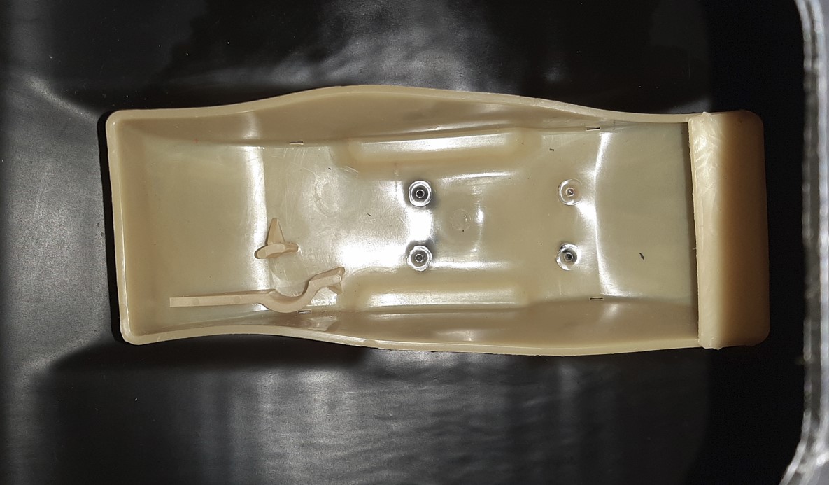

The first time I had the tank out I found the sending unit arm was stuck against the side of the slosh box because the box was warped and catching the float arm. I folded over a strip of 18ga sheet metal to reinforce the side edge and it solved that problem. Now I just need the float to actually float.
Before
After

yes warp is E10 fuel, USA fed mandate on ethanol. it warps plastic or the last guy put in non e10 rated parts.
and great cure, metal sandwich.

Yes these tips worked for me after searching the internet and finding no help other than buy a new tank and buy a new pump with a sending unit. I spent an hour searching for that silly little float cylinder and never came across one. Yes I checked Rock Auto and found they usually have everything and often have the quality items I can trust. These fixes cost me nothing and solved my problems. I finally have a gas gauge that's accurate when reading empty which is all that counts for me. Beats guessing by using the trip odometer.
