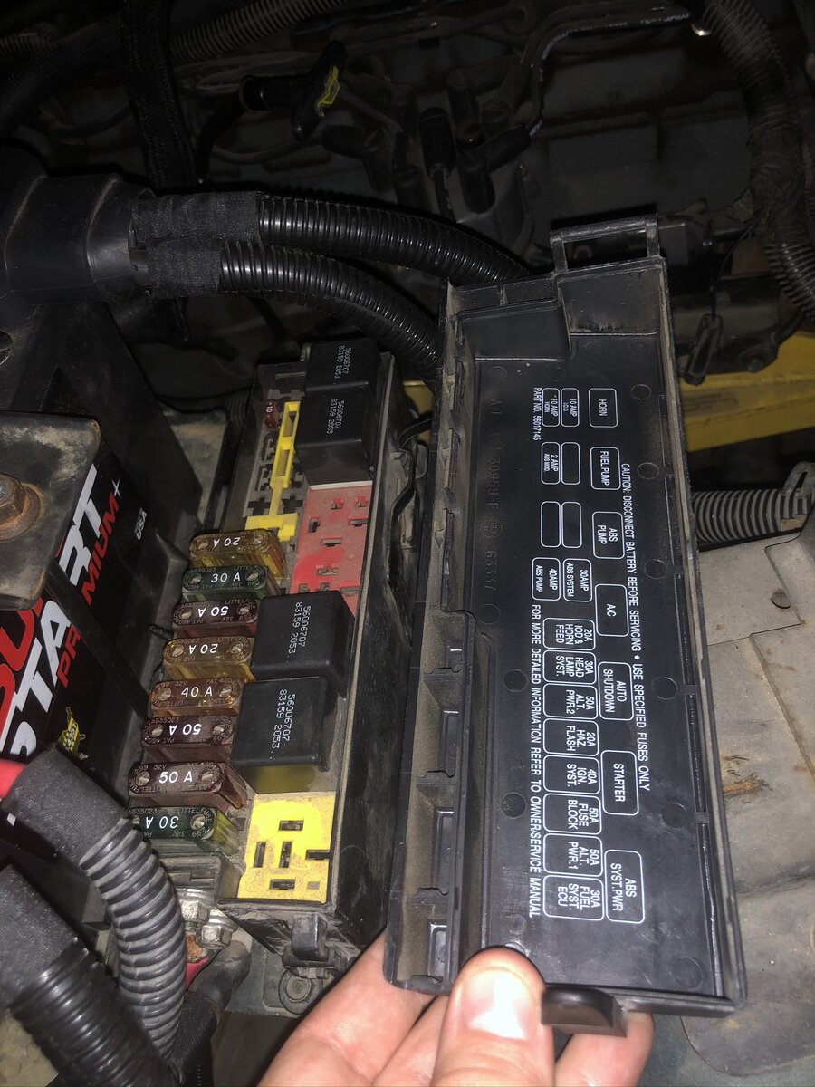

There is no issue with moving the relays around to test. Mine are still original Mopar from 1993. They are all the same part number and amperage rating. Check out my attached pic and save it for future reference in case you ever need it again. Maybe consider buying a lid from eBay if you can find one.
As for your issue, I couldn't tell you why you're having so many issues and the intermittent fuel issue. That's a weird one for sure since you have a new pump and moving the relays didn't really fix it, except sometimes temporarily. That is really bizarre. Maybe some sort of short somewhere or a wire below the PDC no longer staying anchored in the box properly and only making intermittent contact? That's really reaching though.

Oops. Just read this one. Guess you had bad contact on them or something. Per my previous post, there is nothing to worry about as long as the relays are factory sized. They are all the same factory part number, so worst case just buy 7 or less (however many you actually need) 56006707's from Mopar and call it good. They still sell the original relays.

Thanks so much for the picture!!! I've tried to figure out relays locations with my Haynes & Chiltons but I can't read a wiring diagram to save my life 😁
