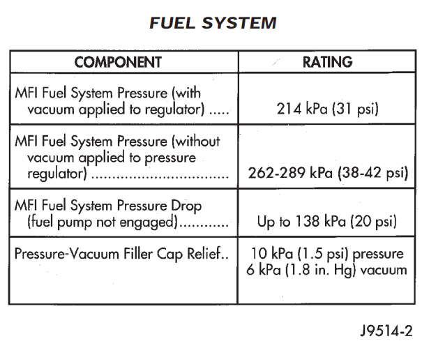

So today I started troubleshooting by checking the plug wires and fuel pressure. In the end I found the one problem is the regulator keeps a steady 31 PSI with vacuum but never increases 8-10 PSI when the vacuum source is removed. I haven't checked the vacuum with a gauge yet but feel a good suction at idle with my fingertip. The vacuum lines and connectors look good. Pressure leak down test is ok for about 15 minutes.
31 PSI is where it needs to be under normal conditions but I don't feel like it works all the time.
I checked the internet, Amazon, big boxes, and they all offer one that fits but they say it's regulated to 41 PSI (or no info) and the complaints from YJ owners are they now get 140 miles per tank where they got 240 miles in the past. So the higher pressure isn't working.
