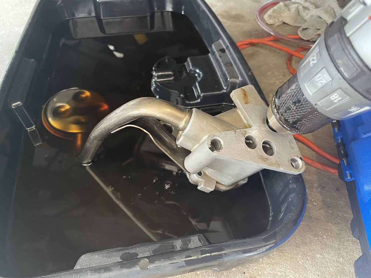

Next I pulled the oil pump to test it by itself. I dipped it in a bucket of oil and spun the drive with a drill. Nothing. Checked the drive and the distributor tip which drives the pump. Both were in great shape, no broken parts. I disassembled the pump and everything looked perfect. It's hard for a gear oil pump to die, they basically just spin forever and ever. I put the pump back together.

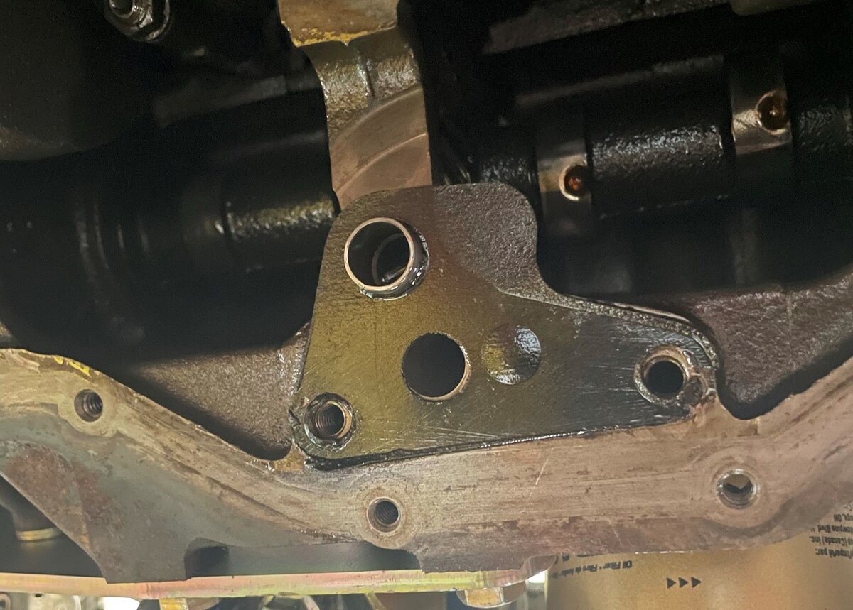

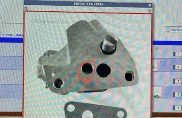

Okay, so what the hell? What could it possibly be? I kept playing with the pump in oil and I noticed hole in the top that didn't correspond to anything in the engine block. Since that hole would be plugged theoretically by the gasket, I plugged it with my finger to simulate installation. I spun it with the drill again, boom, after 5 second oil started coming out of the top. So obviously the old pump worked.

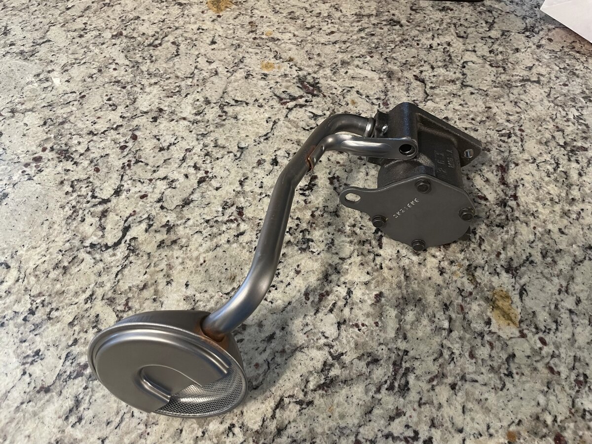

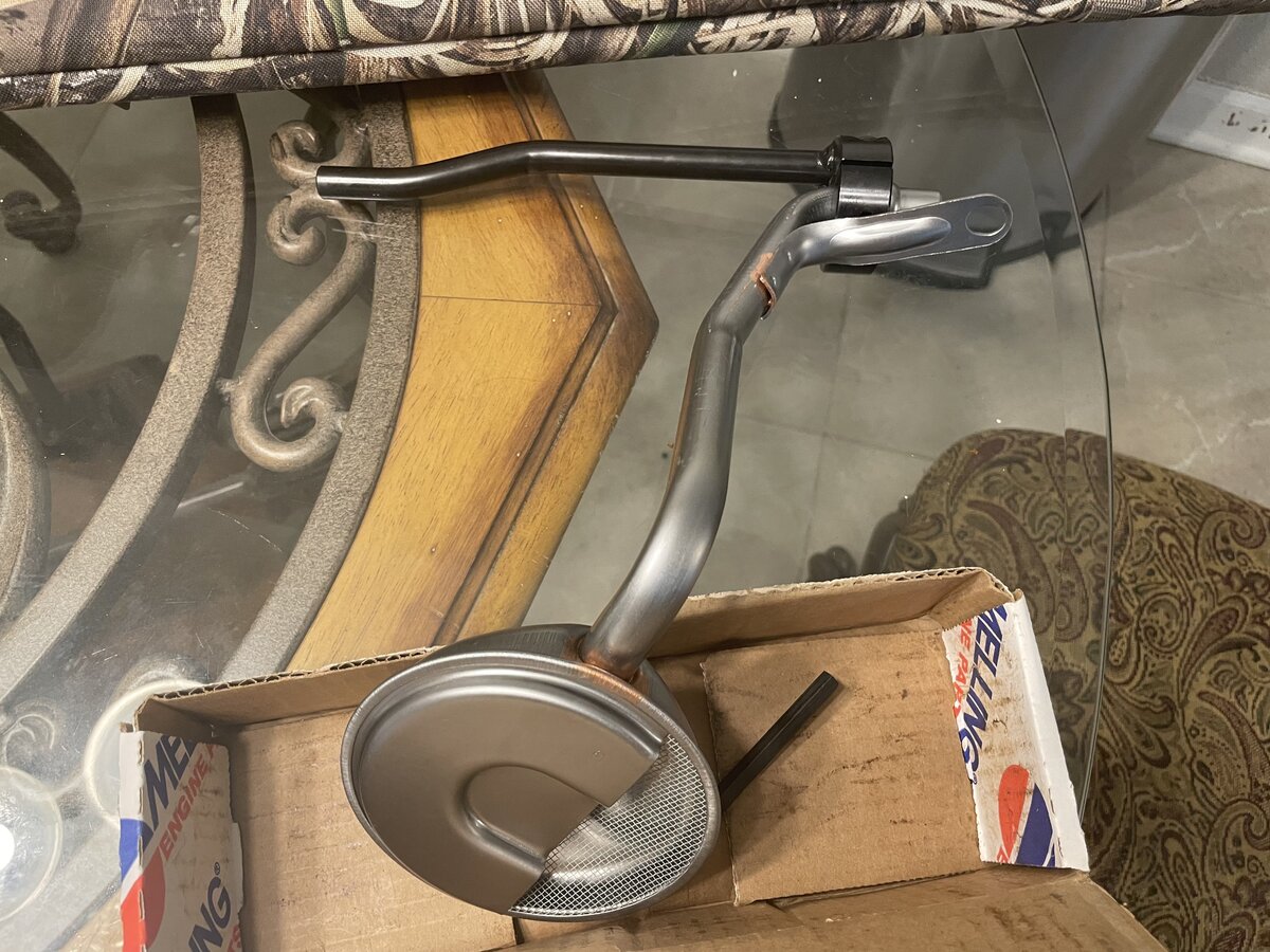

When I did my rear main seal, I wanted to change the dented pickup tube. The pickup tube has a bracket on it that overlaps one of the pump's mounting bolt holes. To try and change the pickup, I removed that bolt. I started yanking on the pickup tube to try and remove it and decided to abort the mission, as I didn't know how hard it would be for me to press in a new pickup tube after the fact. I put the bolt back and forgot about that idea. Fast forward to now, after discovering the hole in the pump that has to be plugged, I wondered if maybe me removing the oil pump bolt in the past ruined that gasket and now the hole wasn't plugging properly, hence no suction?? You can see the bulge where the empty hole pressed against the gasket, so I was wondering if me removing that right side bolt for the pickup tube and then reinstalling possibly screwed up the gasket sealing with that hole, hence losing suction.
So, I ordered a new pump, pickup tube, and gasket. With all of this I figured new parts are best. I tested the old pump in some nasty oil too, so getting a nice new clean part to work with seemed like a good idea. Today I got all the parts:

Nice new pump and pickup tube pressed together...

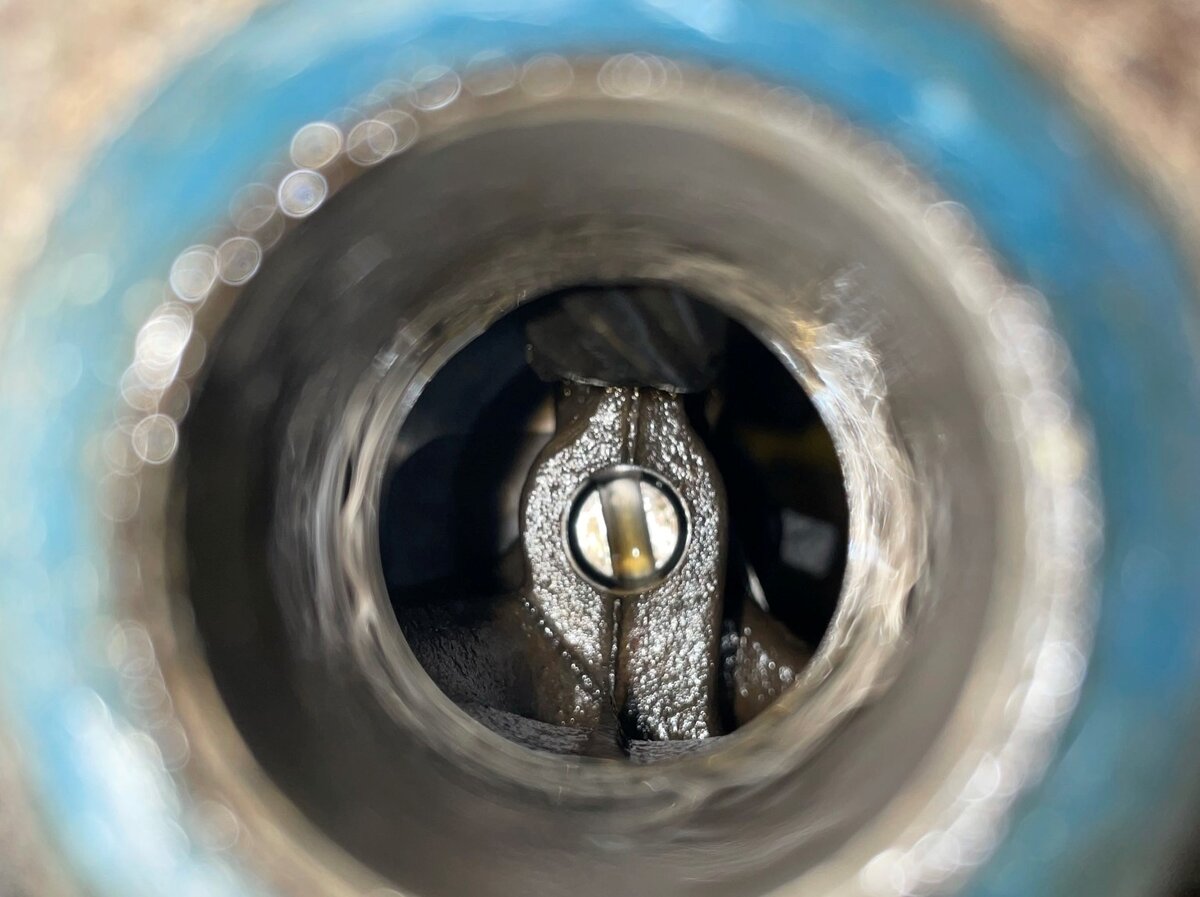

After something like THREE minutes, I FINALLY got oil pressure. I was monitoring the oil through the filter spot. I removed the filter. The oil gets pumped to the filter first, so as soon as oil came out of the filter hole I knew. Then I put the filter back on, put the oil pan, starter, etc on. I filled the oil pan up with 6 quarts of oil and did a crank with the starter. Finally, some damn oil pressure when cranking! I could have sped this process up by packing the oil pump with vaseline, but I didn't want to open up the brand new pump because it has a gasket in it that I didn't want to mess up and then introduce more questionable areas of possible failure.

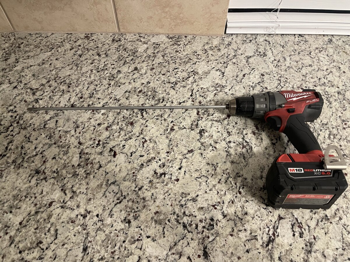

Pic of the oil pump that you "spin" with the drill from above. You stick the flathead screwdriver into here and run the drill clockwise, simulating the job the distributor usually does.

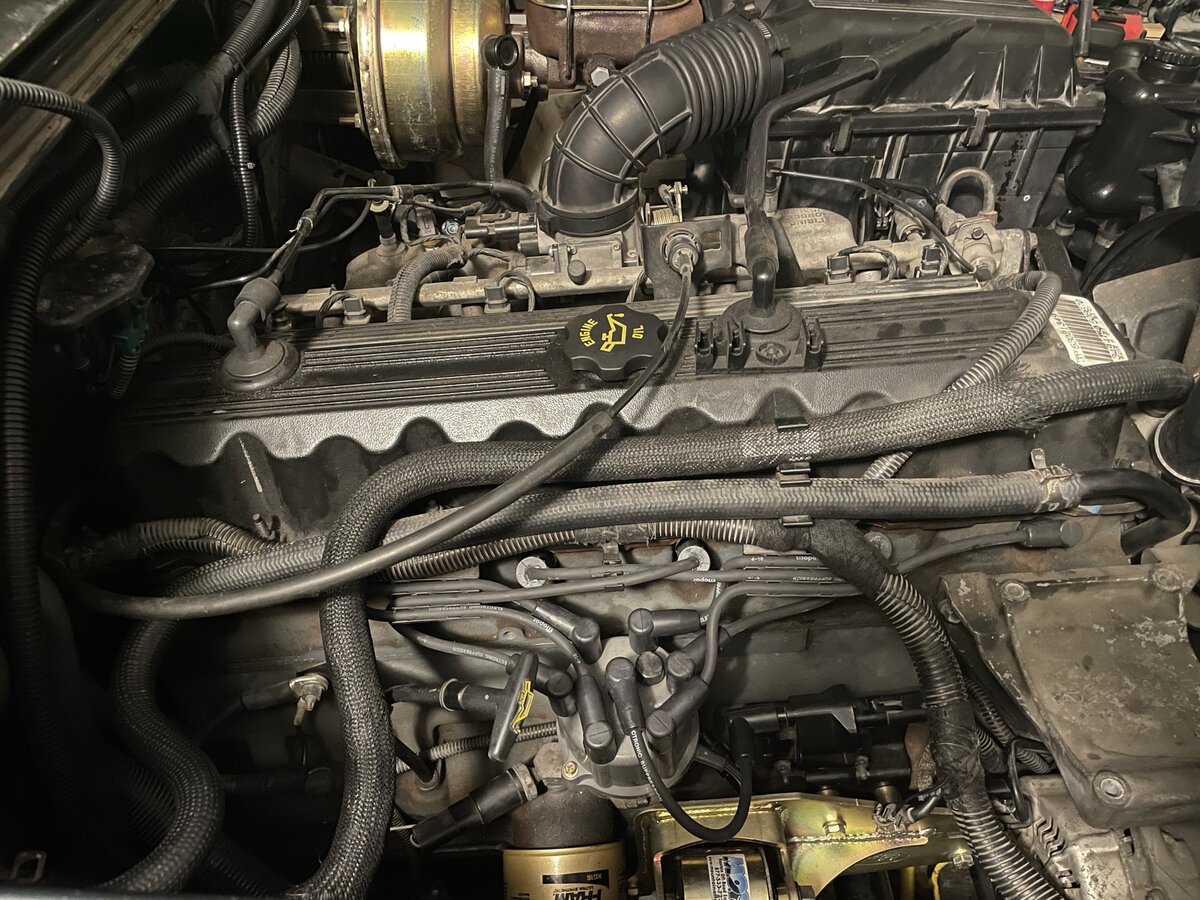

I finally got my new Mopar spark plug wires too so I went ahead and installed them today after the engine was running properly again. What a damn mess. At least I know I have a good oil pump and pickup tube now!
