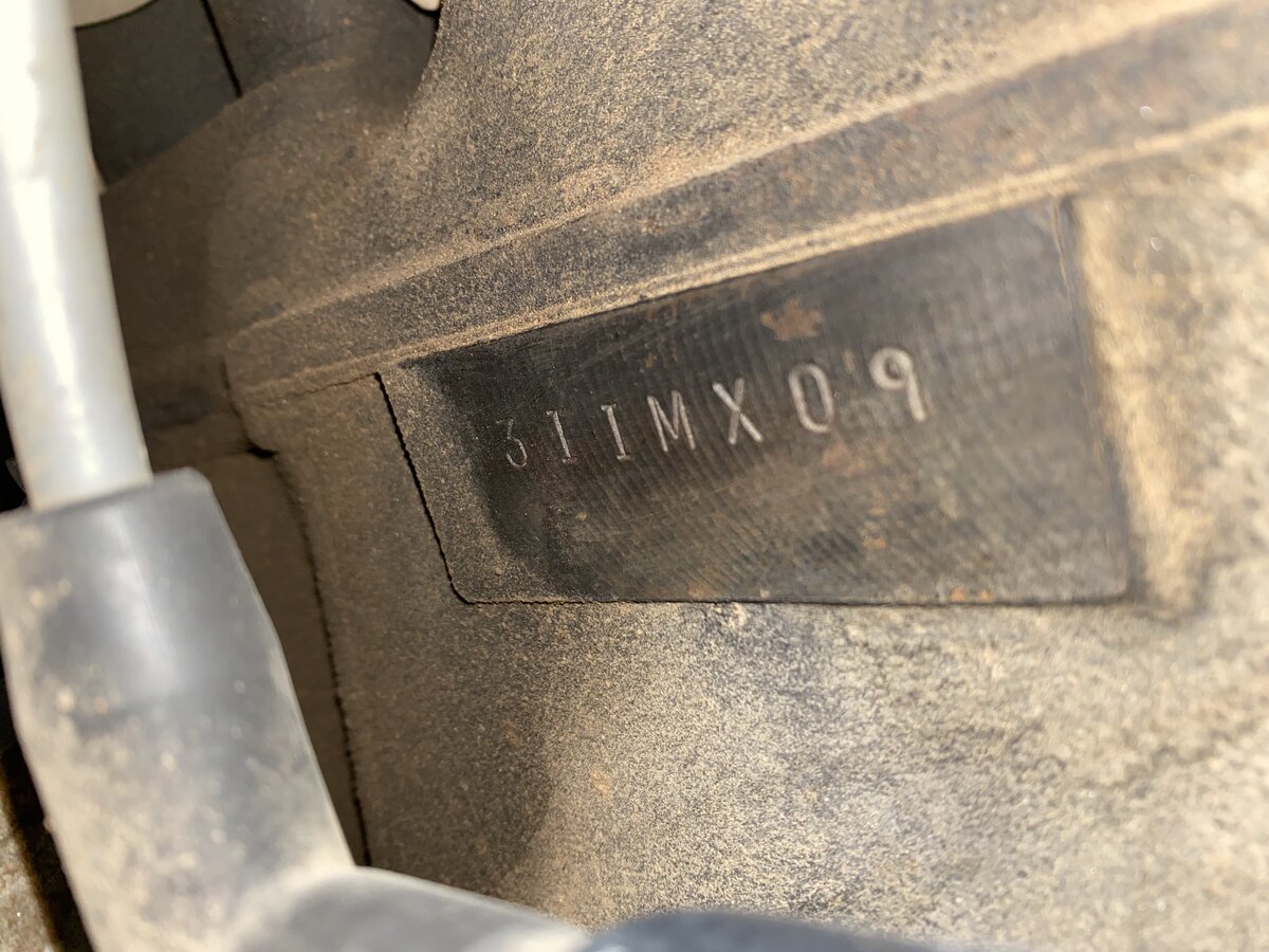

I just bought a Jeep Wrangler YJ 94 Sahara and am trying to narrow in on which engine I have specifically. It’s the 6 cy 4.0, I plan to dive in on this as a project jeep and want to start buying engine replacement parts but want to make sure I’m buying the right stuff first, where can I check to narrow in on the specs? All I can tell from this picture is the year month and day this engine was made.
What are you needing to determine? you have the 4.0 straight 6, there is only one version of that engine. Buy parts based on year and you'll be fine.
All 4.0's from 91-95 are the same except for the 91 manual trans used a crankshaft that needs a smaller pilot bearing, and some of the late 95s used the newly refined TJ engine which was mostly the same except for some tuning differences, a newer style valve cover and gasket, and a different belt and accessory layout.
What parts are you trying to buy?

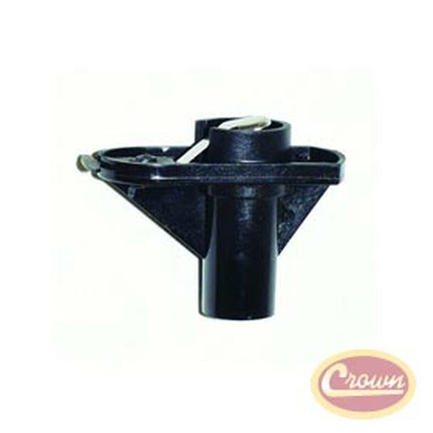

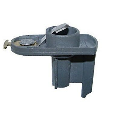

They did change the distributor in 1994 so you will need to figure out what distributor you have before ordering the cap and rotor. Otherwise everything else is basically the same across all years.
1994 could have either distributor, you can tell which one you have by looking at the rotor under the cap. I don't know when they officially switched but my 94 Jeep (built october 93) had the old style and two of my buddies with 94s ( don't know their build dates) had the newer style. The difference is that the rotor will either have a prong sticking down to lock the rotor to the distributor, or a keyway will be built into the rotor's base which locks it to the distributor. Pull the cap and see what rotor you've got, and you'll know. The downside to the older distributor is that the cam position sensor (also called ignition pickup coil) is harder to change, the distributor has to be removed and taken apart to change it, which is dumb.
As for distributor caps, I can't figure out what the differences are. The parts stores will list different caps to go with the old or new rotor. They look 100% identical in pics other than color. If you buy a Mopar tune up kit, they will give you one cap, and just give you both rotors to suit whatever distributor you have. So I really don't think the cap you buy is important. I always get the brass terminal version of whatever Napa says goes with my rotor. Never had a problem so not much more brain power to put into it.
Rotors:
Old style (what my 94 built in 93 has):
Newer Style
