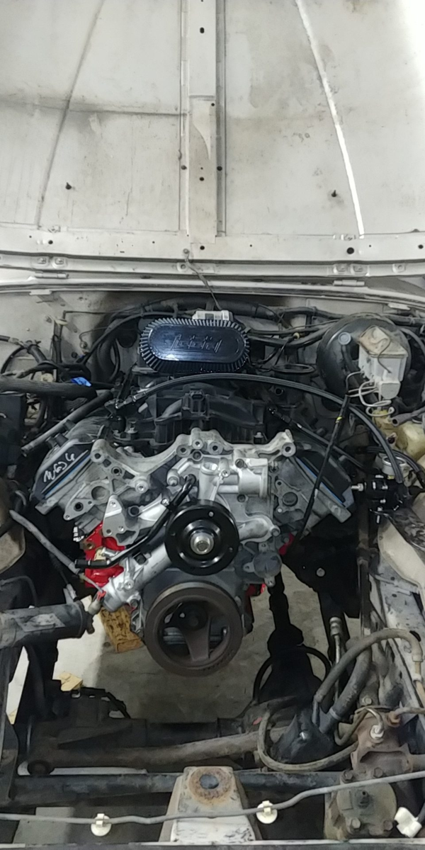

I'm doing an engine swap to put the 5.7 into the Jeep. It seems like everything on the Holley will work fine, but I'm unsure about the rest.

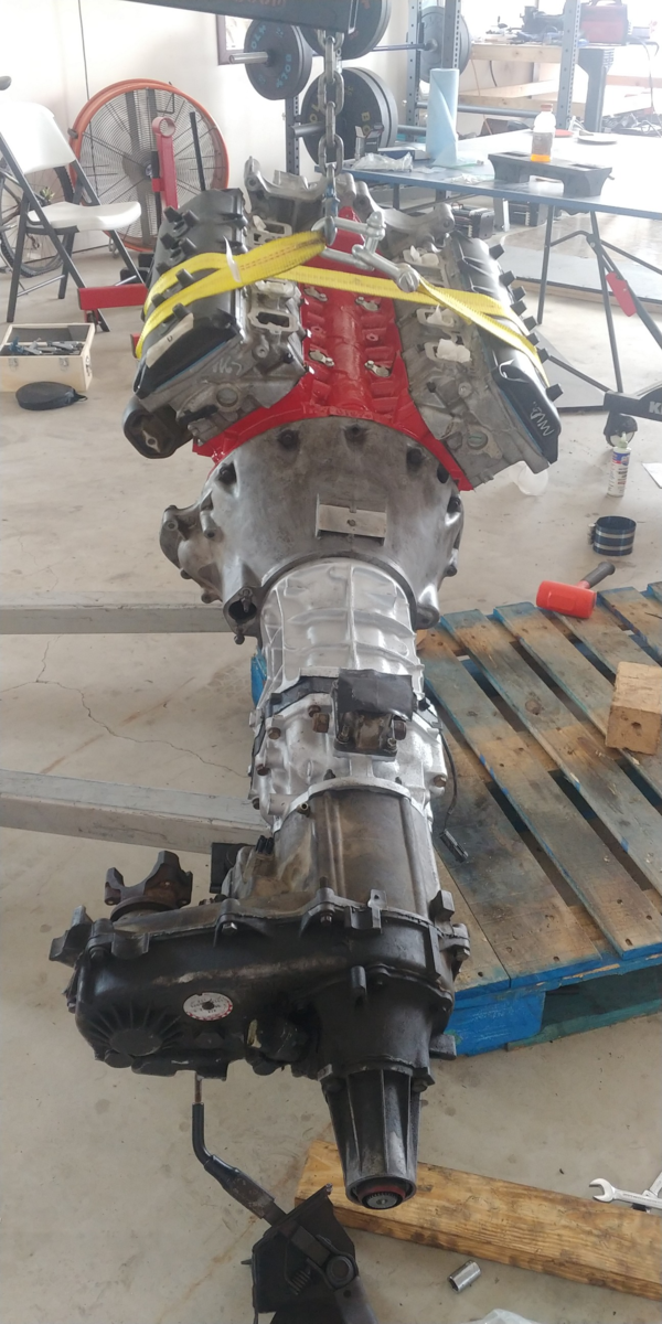

It goes: 5.7L, '92 Dodge Dakota bellhousing from a 3.9L, '97 AX15, np231
Flywheel and clutch kit is from a '04 Dodge Dakota with the 4.7L
