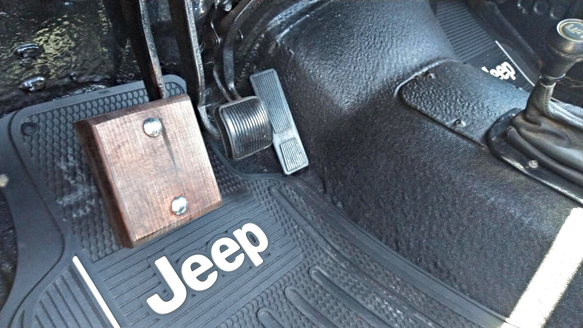

My wife likes to drive the YJ, but she is also a little short and couldnt depress the clutch all the way to the floor. I have the Corbeau seats and bracket that adjust enough for here to be able to depress the gas and brake pedals, also a tilt wheel. But, she was just a little shy for the clutch pedal.
So I used a metal bracket and bolted a piece of cut 2x4 that added 1-5/8" to the pedal and did the trick for her. Its no problem for me because I just slide the seat back when I'm driving it, which is most of the time.
