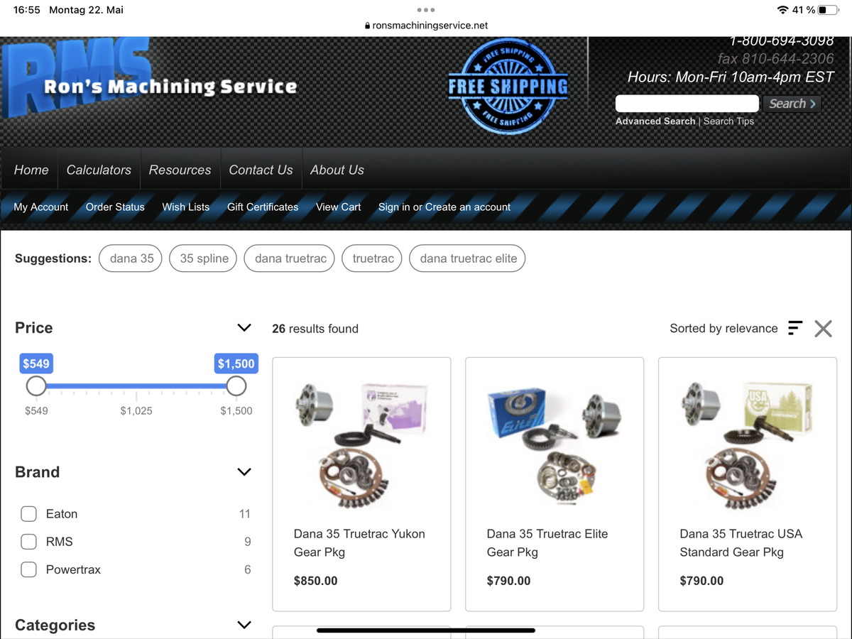

I like that suggestion a lot. I have 33‘s mounted on some nice Mickey Thompson wheels, just waiting for the Discoverer set to wear down. I found this earlier:
plus shipping and tax, gets me around $1k.

The gear package deal seems like a good deal. I run Revolution gears myself but being in Germany cost-efficient options are probably less likely, so for Germany that seems like a good deal.

Exactly, cost plays into every modification just as satisfaction. The shipping and 19% tax on both, item and shipping, can adversely affect ones decisions. But if it‘s only a few euros difference then it makes the choice clear. Yukon, I have heard of, but Elite and USA Standard, I have not heard of. Being this, the first time I have ventured into rebuilding axles, I do not want to risk buying something I will later regret. But I also have to consider, that i will not be going out every weekend in mud or dirt and likely never Rock climbing.
The reason for researching and posting here is to get your responses for advice into my decisions. This is all great input. I have watched several videos, BFH, UcanDoIt2 and many, many others. I am ready for the work requirement, I just have to make up my mind, which gears to buy along with the TT carrier. Only $60 difference between the Yukon and the two others, is not a deterrence. So, I am leaning toward Yukon.
