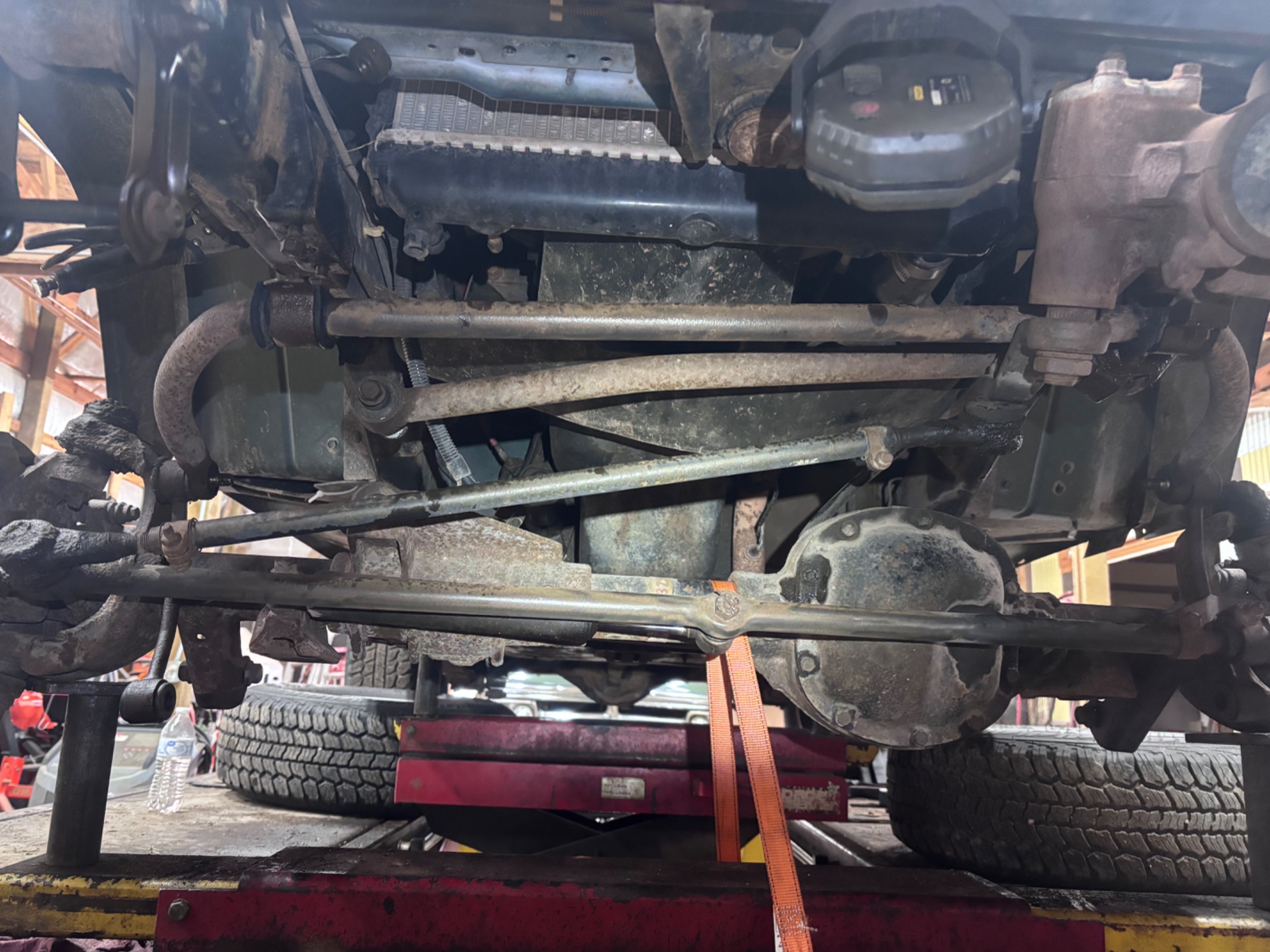

I have a leak on my passanger side axle. There was a tint bit of oil in there when i pulled the axles for u joints but after i put them back together i have a pretty decent leak coming out of the axle. I am just assuming that this would be caused by the outer seal thats by the vacuum or is this caused by the inner seal thats in the pumpkin? Also does any body know of a good tool to sit that seal thats on the outer side? Ive tried to look it up and only see the press for the seals in the pumpkin.
Yeah i filled it all the way up, everything is together, i drove it for 2 days then today i saw a small puddle on the ground and the whole back side of my hub assembly has oil on it.

What diff cover does it have? That sounds significantly worse than what happens when you fill it up to the stock fill hole ordinarily. I would assume aftermarket cover with the fill hole way too high, otherwise maybe a clogged breather.
Im pretty sure its stock, but thats the best photo i have of it right now.
That is a stock cover. Crazy you’re losing that much oil. Might need to go back in there and replace that seal.
