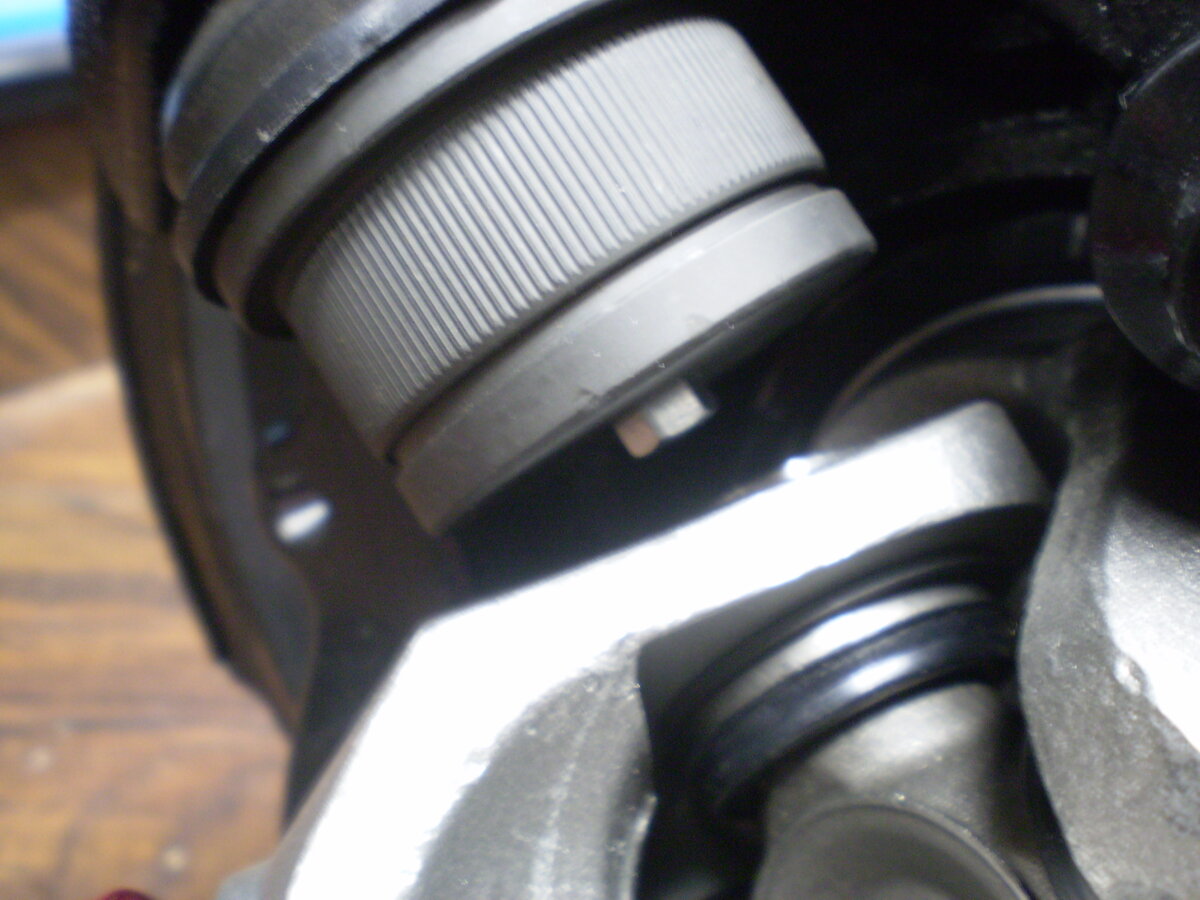

Just got the OMIX BJ's and believe it or not, they actually look like better quality.
Really like the black oxide coating, Spicers are bare steel.
And the lowers are greasable, the Spicers aren't.
The uppers appear to have longer telescoping distance, too.
Guessing that is to improve strength as well?
Just did a fit check, and Oh Yeah, they're gonna be a good press!
Not going to bother with the Loctite, oh well, I'll find other uses for it.

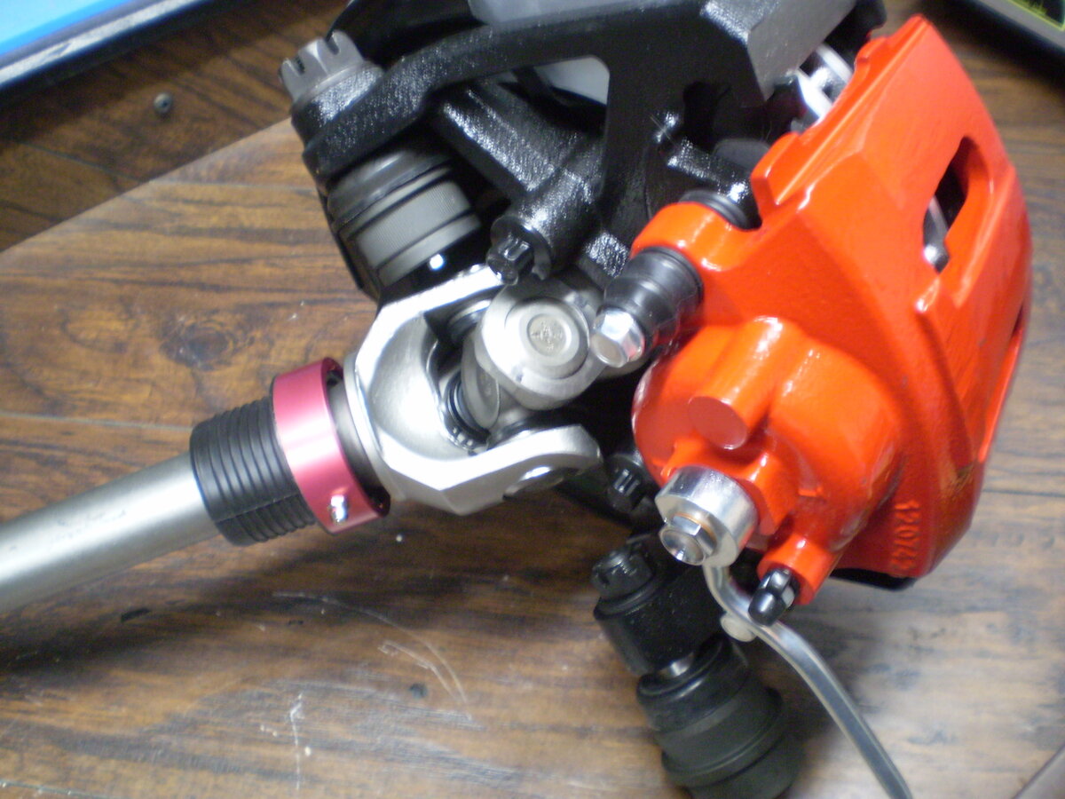

Minor snag on test fitting, the Spicer lowers aren't greasable for a reason, a zerk won't clear the axle.
Guess I gotta buy some zerk plugs, no big, ACE probably has those for less than a buck. Meh...
This is why we test fit everything on the bench First.
Too close for a Zert.
The plug is actually out of my tie-rod kit, but there is only one and it must be in the kit for reason.

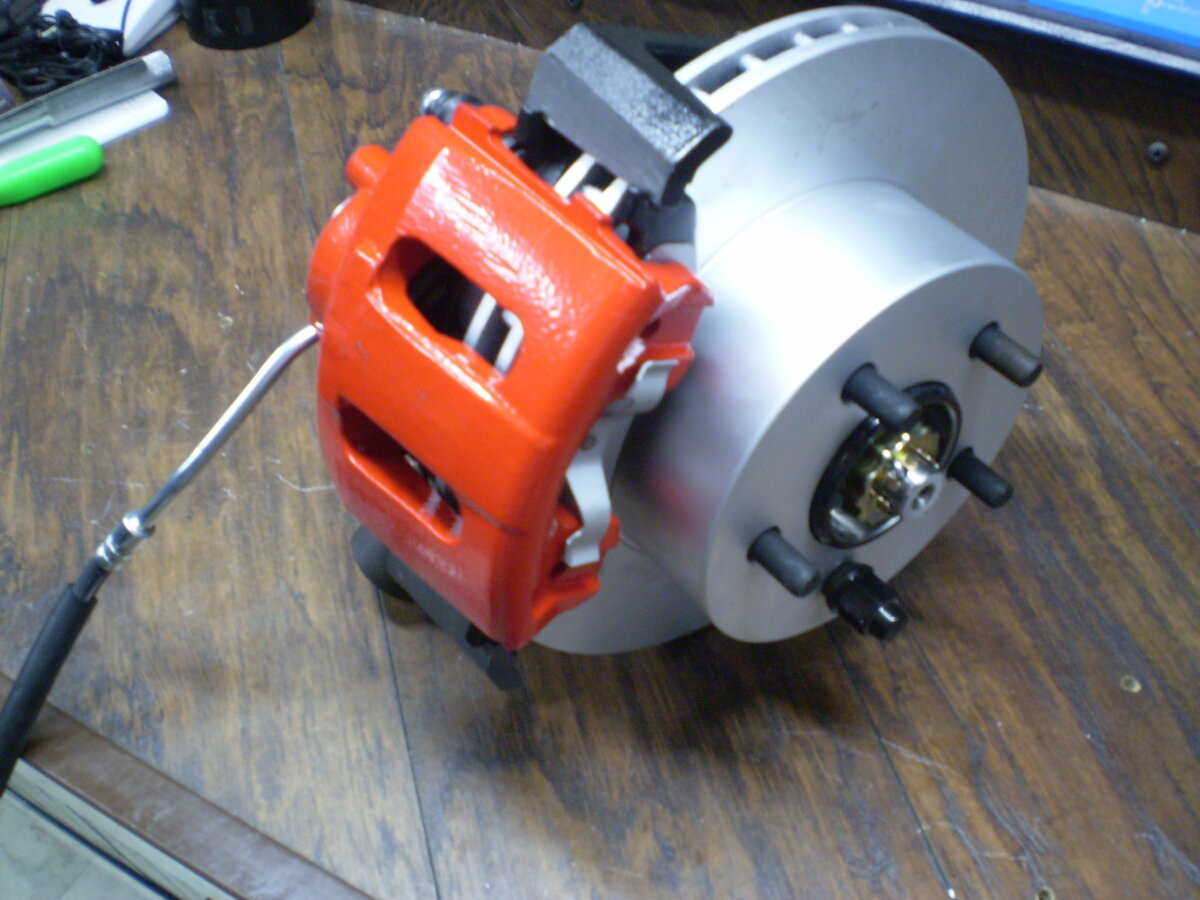

Rest of the new stuff including the Raybestos extended brake line that Macho turned me on to.
Very nice, and inexpensive to boot! One line cost about as much as both banjo bolts.
I thought tube seals might be also be a nice addition to those FAT chromos, since I'm here.
Other side..Coated caliper and rotor from Rock.
Nothing Earth shattering here.
