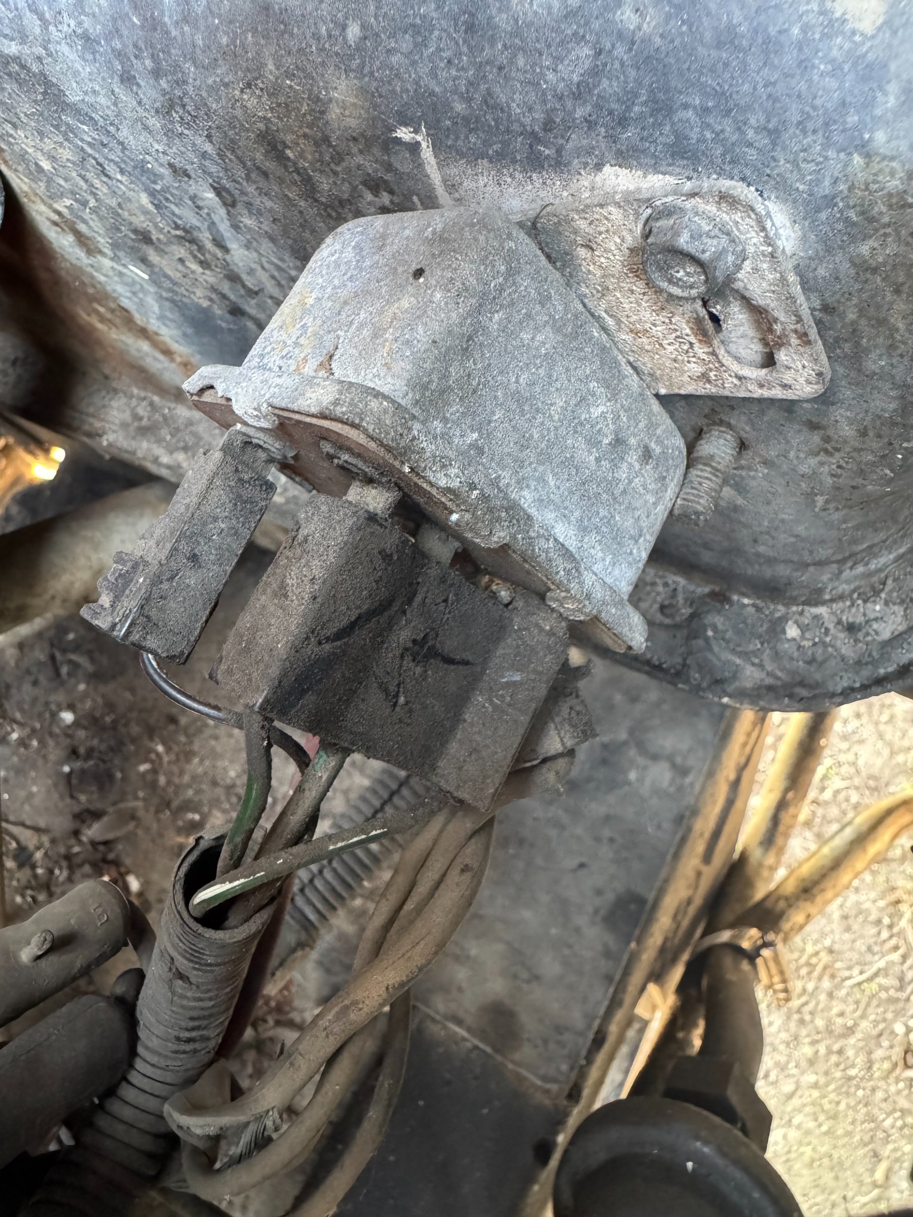

NOTE: I'm just following the power leads from the battery.
One goes to the starter and one goes to this crusty little device (see pic).
Any info / thoughts?
Could this be the gremlin?

Hmm, I also discovered some bare wire attached to this device (I'll call it a relay) as seen in the bottom of the photo.
I'd better wrap those up before I re-install.
That was it!
Bad starter relay!
Started right up.
I just followed the power path from the battery.
So, this is what goes "click" when I turn the key.
No click, no power.
Look like alot of things depend on this device for power (with the key on).
Little victory.
